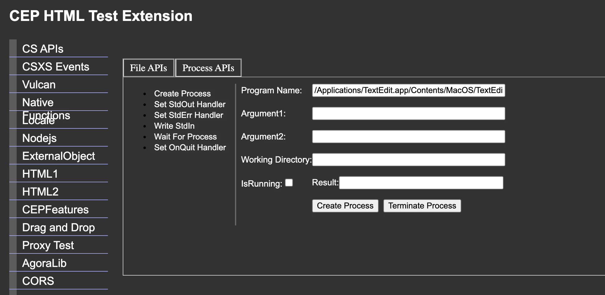

Apr 16, 2025 3:19 PM UTC
execFile is for ExtendScript, not JavaScript.
CEP HTML Test Panel shows how to access the system command line:
