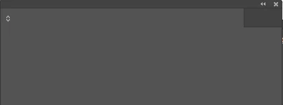

BUT as we switched to CC 2017 this function does NOT work as expected any more. It does clean all contents within the panel, but the empty panel frame kept shown until the user clicks "x".
FURTHERMORE a panel is not closed completely via closeExtension() when it's defined as <UI><Type>Panel</Type>... </UI> in manifest.
If the type is changed to <Type>ModalDialog</Type>, the function closes the whole panel as it used to be.
We tried CSXS 5, 6 and 7, all act the same.

After your suggestion I rechecked the code and used window.__adobe_cep__.closeExtension() directly.
The results are the same. All the contents inside the panel are cleaned but the UI (empty frame) is still present.
Tested with CEP 5, 6 and 7. This problem occurs only on CC 2017. On CC 2014 and 2015 the function works fine.
