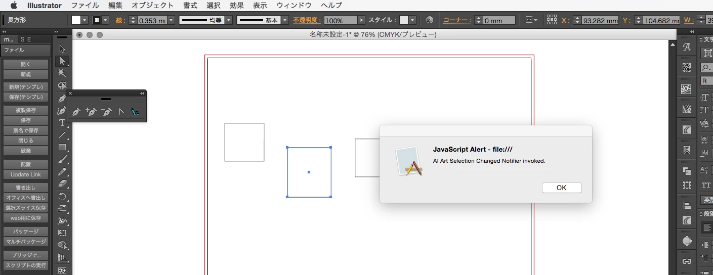

Mar 17, 2015 2:08 AM UTC
First, we need to install "AIHostAdapter.aip" plug-in in "Adobe Illustrator CC 2014->Plug-ins->Extensions".
Below Javascript code is sample of catch ART_SELECTION_CHANGED notifier.
$(function() {
  AIEventAdapter.getInstance().addEventListener(
  AIEvent.ART_SELECTION_CHANGED,
  function(eve) {
  alert(eve.type +" invoked.");
Working image:
Ten
