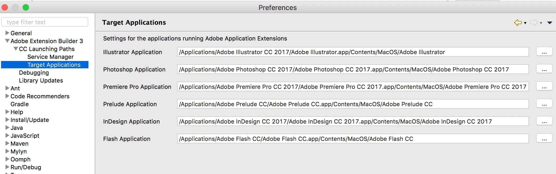

I had the same problem and here is how I fixed it.
On Mac, when you select the target application as per the screenshot below
eclipse, automatically expands the path to the executable inside the package. The path to which it expands is "incorrect". Go to terminal and find the correct path upto the executable inside the package and use that path.
Hope this helps.

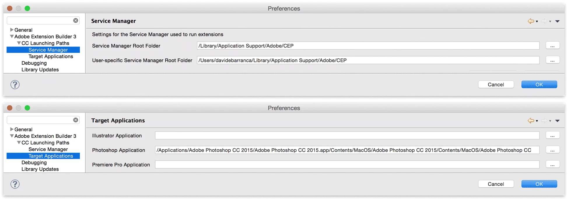

Nov 2, 2015 4:20 PM UTC
The paths in there needs to point to the exec inside the Photoshop.app package:
Hope this helps.
