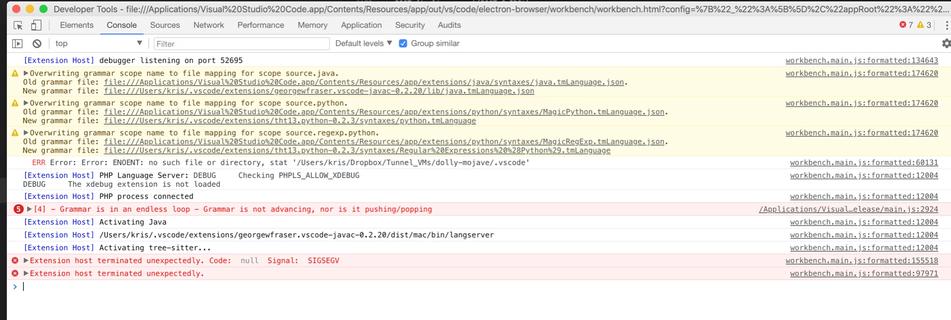

After the two areas reversed, the extension host crashed.
And after that, the variables inspector stopped updating: it keeps on showing invalid data. There is no additional trace info that appears.
I had to quit everything, do a killall "Code Helper".
Then tried some more, and that killed the extension host again. Nothing in the trace data.

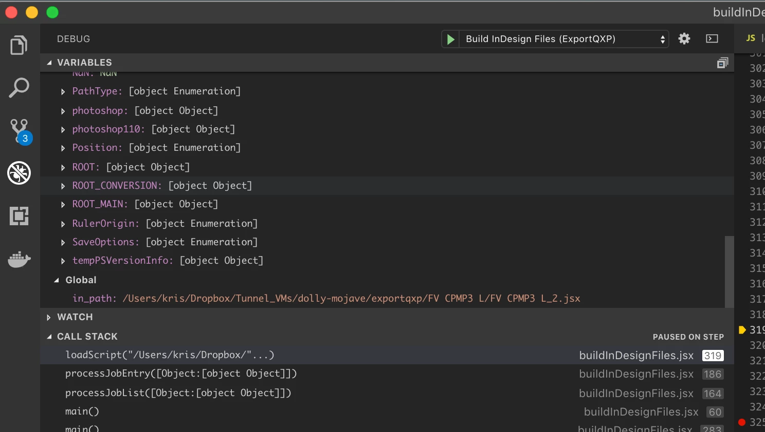

Ok, captured an oddity. The screenshot shows that 'Global' and 'Local' are reversed. But I think the trace info seems to indicate that the data being received is not reversed, so something in the display logic seems to go wrong.
Trace info:
{"0":"<properties object=\"\" engine=\"com.siliconpublishing.inDesignESDriverSnippets\"><value type=\"Object\" name=\"this\" readonly=\"true\"><![CDATA[[object Object]]]></value><property type=\"string\" name=\"in_path\" state=\"new\"><![CDATA[/Users/kris/Dropbox/Tunnel_VMs/dolly-mojave/exportqxp/FV CPMP3 L/FV CPMP3 L_2.jsx]]></property></properties>"}
{"0":"<trace>[1563497466021] sendVariableRequest Successful.</trace>"}
{"0":"<properties object=\"$.global\" engine=\"com.siliconpublishing.inDesignESDriverSnippets\"><property type=\"Application\" name=\"app\" state=\"\" readonly=\"true\"><![CDATA[[object Application]]]></property><property type=\"error\" name=\"incopy14\" state=\"\"><![CDATA[No documents are open.]]></property><property type=\"Array\" name=\"apps\" state=\"\"><![CDATA[aftereffects-16.0,ame-13.0,ame-6.0,ame-7.0,bridge-5.064,bridge-9.064,dreamweaver-19.1,estoolkit-3.8,estoolkit-4.0,exman-6.0,illustrator-16.064,illustrator-17.064,illustrator-18.064,illustrator-19.064,illustrator-20.064,illustrator-21.064,illustrator-22.064,illustrator-23.064,incopy-14.064,indesign-10.064,indesign-11.064,indesign-12.064,indesign-13.064,indesign-14.064,indesign-8.0,indesign-9.064,indesignserver-13.0,photoshop-130.064,premierepro-13.0,switchboard-2.0]]></property><property type=\"Object\" name=\"incopy\" state=\"\"><![CDATA[[object Object]]]></property><property type=\"Object\" name=\"tempPSVersionInfo\" state=\"\"><![CDATA[[object Object]]]></property><property type=\"Object\" name=\"photoshop\" state=\"\"><![CDATA[[object Object]]]></property><property type=\"Object\" name=\"photoshop110\" state=\"\"><![CDATA[[object Object]]]></property><property type=\"Object\" name=\"bridge9\" state=\"\"><![CDATA[[object Object]]]></property><property type=\"Object\" name=\"bridge\" state=\"\"><![CDATA[[object Object]]]></property><property type=\"Object\" name=\"aftereffects16\" state=\"\"><![CDATA[[object Object]]]></property><property type=\"Object\" name=\"aftereffects\" state=\"\"><![CDATA[[object Object]]]></property><property type=\"Object\" name=\"illustrator\" state=\"\"><![CDATA[[object Object]]]></property><property type=\"Object\" name=\"indesign11\" state=\"\"><![CDATA[[object Object]]]></property><property type=\"Object\" name=\"indesign\" state=\"\"><![CDATA[[object Object]]]></property><property type=\"Object\" name=\"indesign13\" state=\"\"><![CDATA[[object Object]]]></property><property type=\"Object\" name=\"indesign14\" state=\"\"><![CDATA[[object Object]]]></property><property type=\"Object\" name=\"indesign10\" state=\"\"><![CDATA[[object Object]]]></property><property type=\"Object\" name=\"indesign12\" state=\"\"><![CDATA[[object Object]]]></property><property type=\"Object\" name=\"ROOT_CONVERSION\" state=\"\"><![CDATA[[object Object]]]></property><property type=\"Object\" name=\"ROOT_MAIN\" state=\"\"><![CDATA[[object Object]]]></property><property type=\"Object\" name=\"ROOT\" state=\"\"><![CDATA[[object Object]]]></property><property type=\"Object\" name=\"JSON\" state=\"\"><![CDATA[[object Object]]]></property><property type=\"Enumeration\" name=\"MeasurementUnits\" state=\"\" readonly=\"true\"><![CDATA[[object Enumeration]]]></property><property type=\"number\" name=\"NaN\" state=\"\"><![CDATA[NaN]]></property><property type=\"number\" name=\"Infinity\" state=\"\"><![CDATA[Infinity]]></property><property type=\"Enumeration\" name=\"SaveOptions\" state=\"\" readonly=\"true\"><![CDATA[[object Enumeration]]]></property><property type=\"Enumeration\" name=\"RulerOrigin\" state=\"\" readonly=\"true\"><![CDATA[[object Enumeration]]]></property><property type=\"Enumeration\" name=\"DocumentIntentOptions\" state=\"\" readonly=\"true\"><![CDATA[[object Enumeration]]]></property><property type=\"Enumeration\" name=\"ColorSpace\" state=\"\" readonly=\"true\"><![CDATA[[object Enumeration]]]></property><property type=\"Enumeration\" name=\"ColorModel\" state=\"\" readonly=\"true\"><![CDATA[[object Enumeration]]]></property><property type=\"Enumeration\" name=\"Leading\" state=\"\" readonly=\"true\"><![CDATA[[object Enumeration]]]></property><property type=\"Enumeration\" name=\"Justification\" state=\"\" readonly=\"true\"><![CDATA[[object Enumeration]]]></property><property type=\"Enumeration\" name=\"CoordinateSpaces\" state=\"\" readonly=\"true\"><![CDATA[[object Enumeration]]]></property><property type=\"Enumeration\" name=\"AnchorPoint\" state=\"\" readonly=\"true\"><![CDATA[[object Enumeration]]]></property><property type=\"Enumeration\" name=\"FitOptions\" state=\"\" readonly=\"true\"><![CDATA[[object Enumeration]]]></property><property type=\"Enumeration\" name=\"PathType\" state=\"\" readonly=\"true\"><![CDATA[[object Enumeration]]]></property><property type=\"Enumeration\" name=\"CornerOptions\" state=\"\" readonly=\"true\"><![CDATA[[object Enumeration]]]></property><property type=\"Enumeration\" name=\"Position\" state=\"\" readonly=\"true\"><![CDATA[[object Enumeration]]]></property></properties>"}
{"0":"<trace>[1563497466069] sendVariableRequest Successful.</trace>"}
