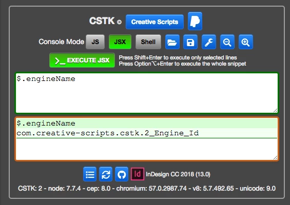

In you host.jsx put this line alert($.engineName);
If all goes well you'll see Sbric.Fab.Engine.1234

I hope to release my CSTK V2 later today it's ID is com.creative-scripts.cstk.2 so it's automatically give the engine name in InDesign as com.creative-scripts.cstk.2_Engine_Id.
