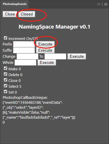

I'm trying to develop an dockable extension that allows me better manage layer renaming,
then stuck at here:
The 2 place where red circles has pointed out are my test adjustment.
The "Close" button does the what it should do---close and make this extension not persistent
I copied the same function to "Closed" button and it run well until I modified it into "alert(app.activeDocument.activeLayer)".
Q1: Why that API can't be called here while it can in ESTK?
I went to main.js to see if I could create the basic construct of my extension.
Then i found my own button didn't work anyway even I copied the code of the "Closed" button.
Q2: How to correctly create anything or check whether it is good to go? Is there a principle or something?

    var PrefixInput = window.document.getElementById("PrefixInput")
    var SuffixInput = window.document.getElementById("SuffixInput")
    var ChangeInput = window.document.getElementById("ChangeInput")
    var ToInput = window.document.getElementById("ToInput")
    var WholeInput = window.document.getElementById("WholeInput")
    btnClose.onclick = function () {    <!--Original function-->
        Register(false, gRegisteredEvents.toString());
        Persistent(false);
        if (window.__adobe_cep__) {
            window.__adobe_cep__.closeExtension();
    btndClose.onclick = function () {    <!--Q1:My tiny adjusted function-->
        alert(app.activeDocument.activeLayer)    <!--Q1:Why this returns nothing-->
    <!--Q2:I created a button named "PrefixExecute" in index.html,-->
  <!--Q2:and why this button is not working even I copied the code of the original func-->
    PrefixExecute.onclick = function () {
        Persistent(false);
Here is my project file.
 PhotoshopEvent
5 replies
Mylenium
Nov 5, 2021 3:23 PM UTC
You somehow have messed up the comments and your functions are considered to be inside them. That's why they don't work. Check that section with the "main.js" reference and remove the comments or at least wrap the lines and close all brackets correctly. I'm pretty sure you'd get the line flagged in a code editor...
Mylenium
LinxyviaAuthor
Nov 8, 2021 9:10 AM UTC
Thanks for your reply! However, I tried to add an "alert" to check.
        x = app.activeDocument.activeLayer.name //This run well in ESTK
        alert(x) //
        Persistent(false);
And it did not run until I removed those codes. How to fix that?
