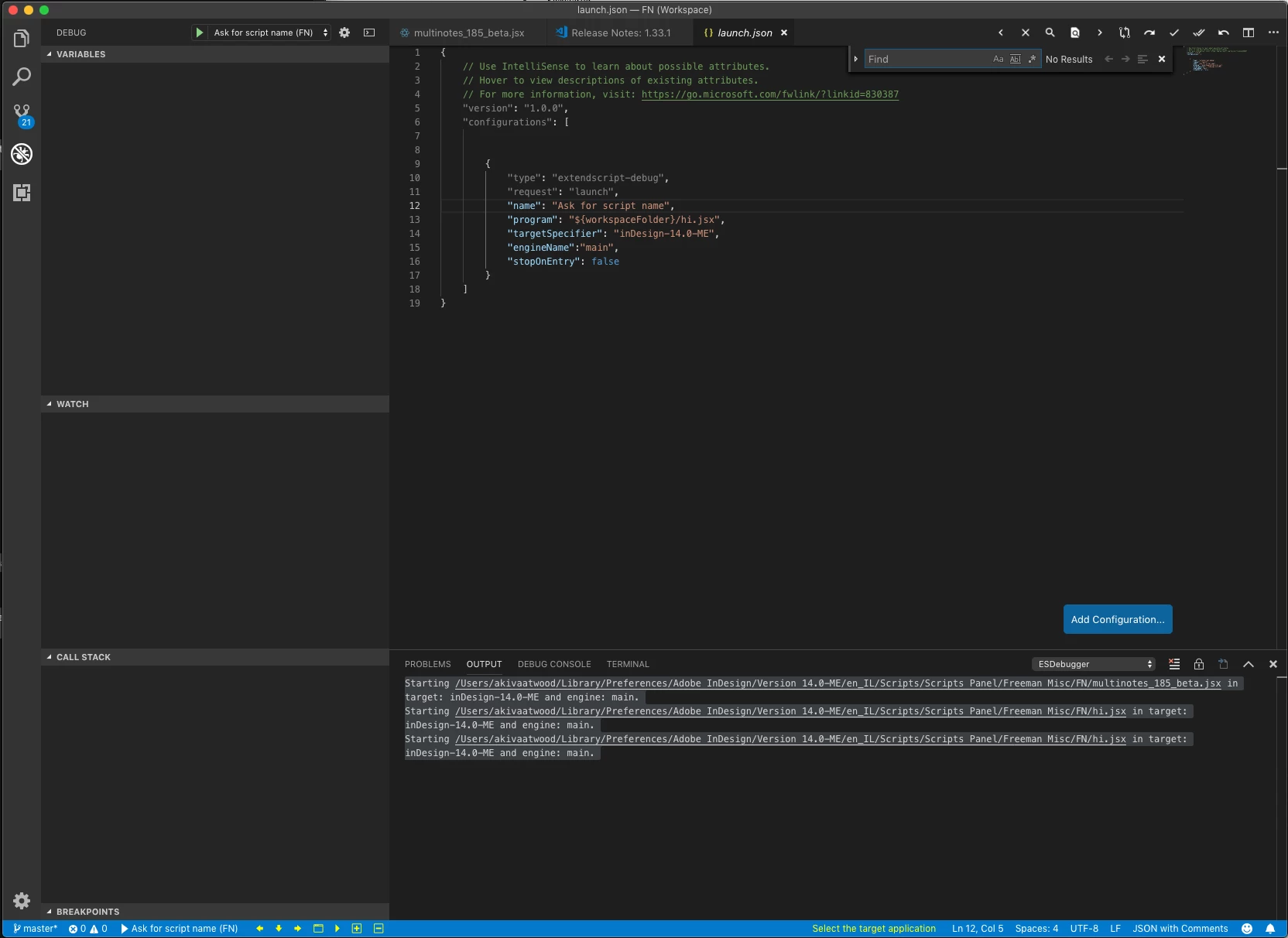

Apr 11, 2019 5:31 PM UTC
Haven't been able to get it working. (OSx, VSC 1.33.1, 1.0.1 plugin)
Uninstalled and reinstalled the plugin
1) The setup instructions don't work -- when I click the plugin gear I get
   // Use IntelliSense to learn about possible attributes.
   // Hover to view descriptions of existing attributes.
   // For more information, visit: https://go.microsoft.com/fwlink/?linkid=830387
   "version": "0.2.0",
   "configurations": [
   "type": "node",
   "request": "launch",
   "name": "Launch Program",
   "program": "${file}"
Which is not what the instructions say should be there.
I replace that with the contents from the install instruction == try to run -- and get
Can’t start a session without an active target and engine. Select an active target and engine before trying again.
I add
"targetSpecifier": "inDesign-14.0-ME",
   "engineName":"main",

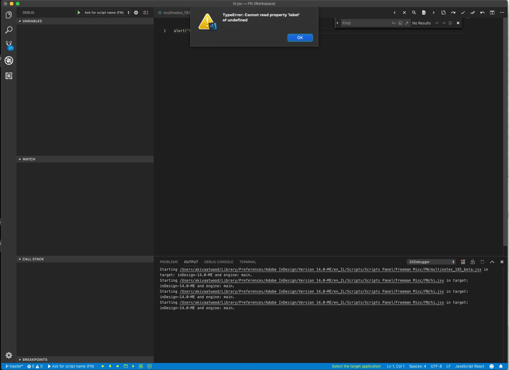

and it starts ID
And gives an error: TypeError: Cannot read property 'label' of undefined
I've been running scripts from inside ID and getting the $.writeln output in the ESTK for now -- but want to get it working.

Apr 12, 2019 5:32 AM UTC
May be there is some syntax error in your script. Can you try with a sample script(`alert("Hello World");`) first and see if that works? Also in the configuration, ` "program": "${file}"` means that your currently focussed script(.js/.jsx) in the editor window will be executed.
