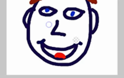

Eraser tool not in sync
I am running CS3 on Windows 10 on a new laptop I just bought.  When I attempt to use the eraser tool, the pointer is not in sync with what is being erased.  It erases in another spot on the screen, so you really have to just guess.  Any idea why this might be happening, and more importantly, how to correct it? Below is a screenshot of how far apart the pointer and eraser actually are.

    I know it's old.  I do run it on another computer that also has Windows 10 and it works fine, but it may not be the same version.  And YES, it is a touchscreen laptop.

    My 2 in 1 does weird things and drives me mad, like the mouse pointer periodically disappearing! Try disabling the touch-pen driver in device manager. Look under Human Interface Devices for something like HID Compliant Pen = right click > disable  .. See if that helps any?
    I'm assuming you were using the mouse pad to control  the eraser tool ?
