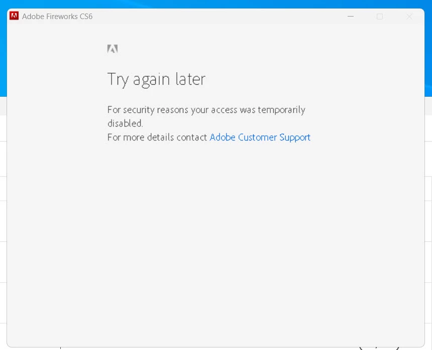

Error opening Fireworks
I have the all apps subscription and it shows Fireworks, but when I try to open it there is an error in the Sign In "For security reasons your access was temporarily disabled"

    Jun 14, 2023 3:06 PM UTC
    quote
    By @elpasographics
    THIS IS THE SOLUTION: You just need to wait.
    (because contacting Adobe Support about this is pointeless, they don't know what to do)
    To anyone that comes here with the specific issue of "For security reasons your access was temporarily disabled", save yourself some time and ignore the so called "experts" suggesting stuff below that has nothing to do with THIS specific error.
    You are locked out of legacy apps authentication because you probably typed your password incorrectly 3 times (it will NOT lock you out of normal account login or Adobe CC login, this is the confusing part, it locks out only the legacy / old apps authentication)
    It took me around 3 or 4 hours to unlock itself out. Then you just make sure you remember your password now and when authenticating again, it will not fail.
    You might want to re-install Fireworks CS6, you DON'T need to do any offline install, the install via Adobe CC works fine (assuming you have a valid subscription and access to the old / legacy apps)
    The first time after being unlocked, the login was automatically done by Adobe CC (I had it open/running) and Fireworks opened.
    I closed it and reopened to test, then the Trial Message appeared saying it was 30 days remaining. At the bottom of this windows there's a button called License this Software - CLICK ON IT, and confirm/authenticate. Fireworks will open normally again, and for now on you will not have more issues neither trial messages happening.
    Best.

    Jun 14, 2023 1:07 PM UTC
    quote
    I remember having a problem with an installation on a project and having to use a virtual machine.  It might be worth a try with W10.
    By @L e n a
    That also has nothing to do with this specific error.
    This happens when the user is asked to sign in and you type the password incorrectly too many times (4 or more), after all we usually don't need to type the Adobe Password ever as Adobe CC is always logged in.
    Then you will get locked out for the legacy apps like Fireworks (doesn't affect your loggin on account and Adobe CC, only legacy)
    And there isn't a solution as Adobe Support is crap and doesn't know what to do.
    The ONLY solution is to wait.
    Happened to me yesterday, had to way around 3 or 4 hours to unlockitself.
    Then it will ask again the password and it works.
    When you close and open the legacy app again, it will show the Trial message, then you should click on the button "License this Software", it will do some stuff on Adobe CC/Browser (might ask you for confirmation) and goes back to the Trial window saying it's now licensed, and that't it.

    Jun 14, 2023 2:42 PM UTC
    Did you go ahead and install as trial? Follow the below exactly, I have done it severasl times on Windows 10 and Windows 11 and it has worked for me, I'm assuming you have a full or student/teacher Creative Cloud subscription?
    This is a Windows solution :
    1) Download the Adobe Creative Clouder Cleaner Tool from here
    2) Remove Fireworks by running the cleaner tool (run as administrator) => select language => agree to terms type'Y' => select 1. All => 2. Adobe Fireworks CS6
    3) Go to C:\Program Files (x86)\Common Files\Adobe\OOBE\ and rename or delete the folder 'PDApp'
    4) Go to C:\Users\username\AppData\Roaming\Adobe\ and rename or delete the folder 'CS6ServiceManager'
    5) Now open the Creative Cloud app and turn off automatic updates; click your profile icon (top right) => Preferences => Apps => make sure Auto-update is off (if you leave Auto-update on, Fireworks will be updated, and you'll most likely end up with the same issue again).
    6) Reboot your system for good measure
    7) Download this offline Fireworks installer that I saved  unzip it and install Fireworks **NOTE** Choose 'Try' when presented with options, you may additionally be asked to sign in with your Adobe credentials.
    😎 When you launch Fireworks for the first time, you may be prompted to sign in with your Adobe credentials, if you then see a button 'license this software' click it, and you should be good to go.
