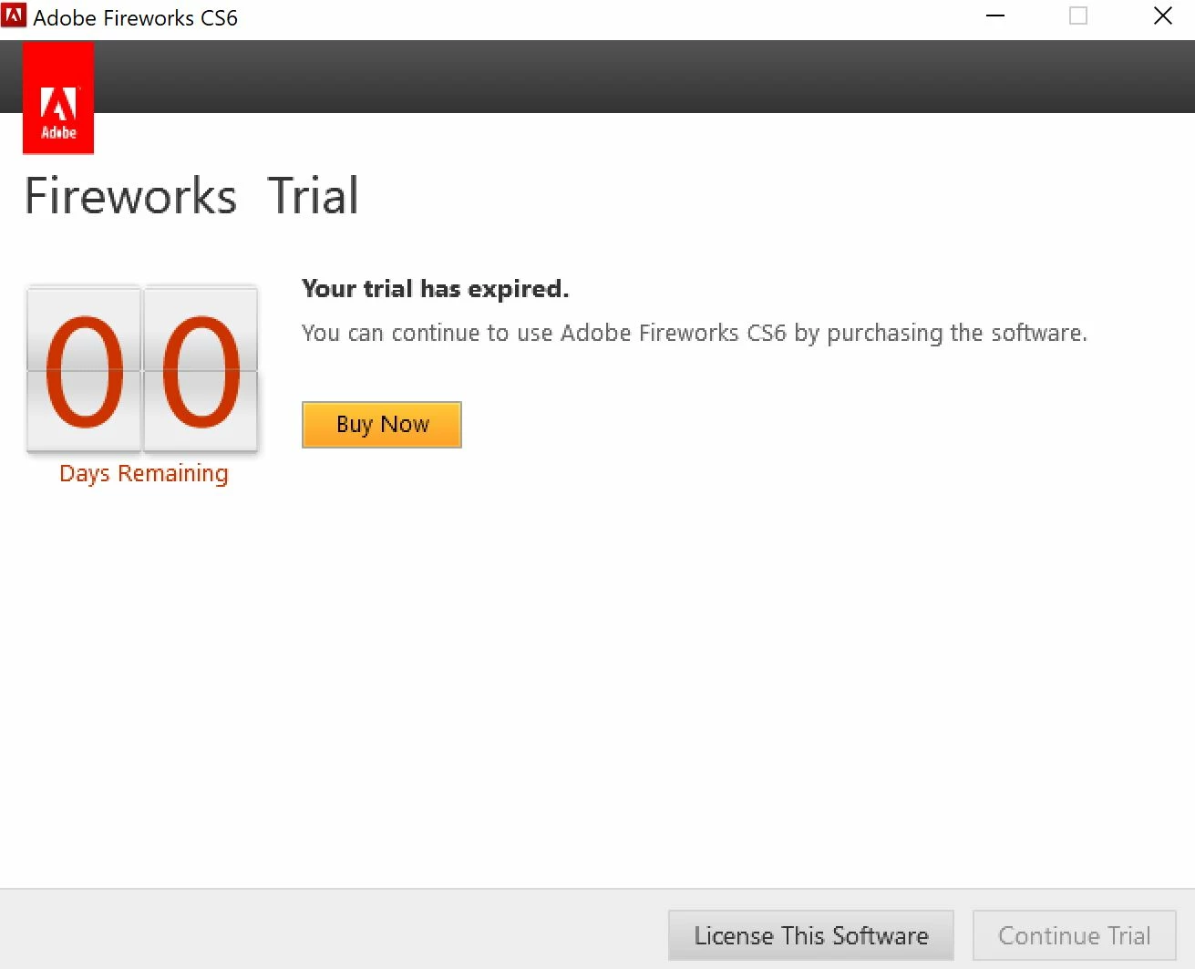

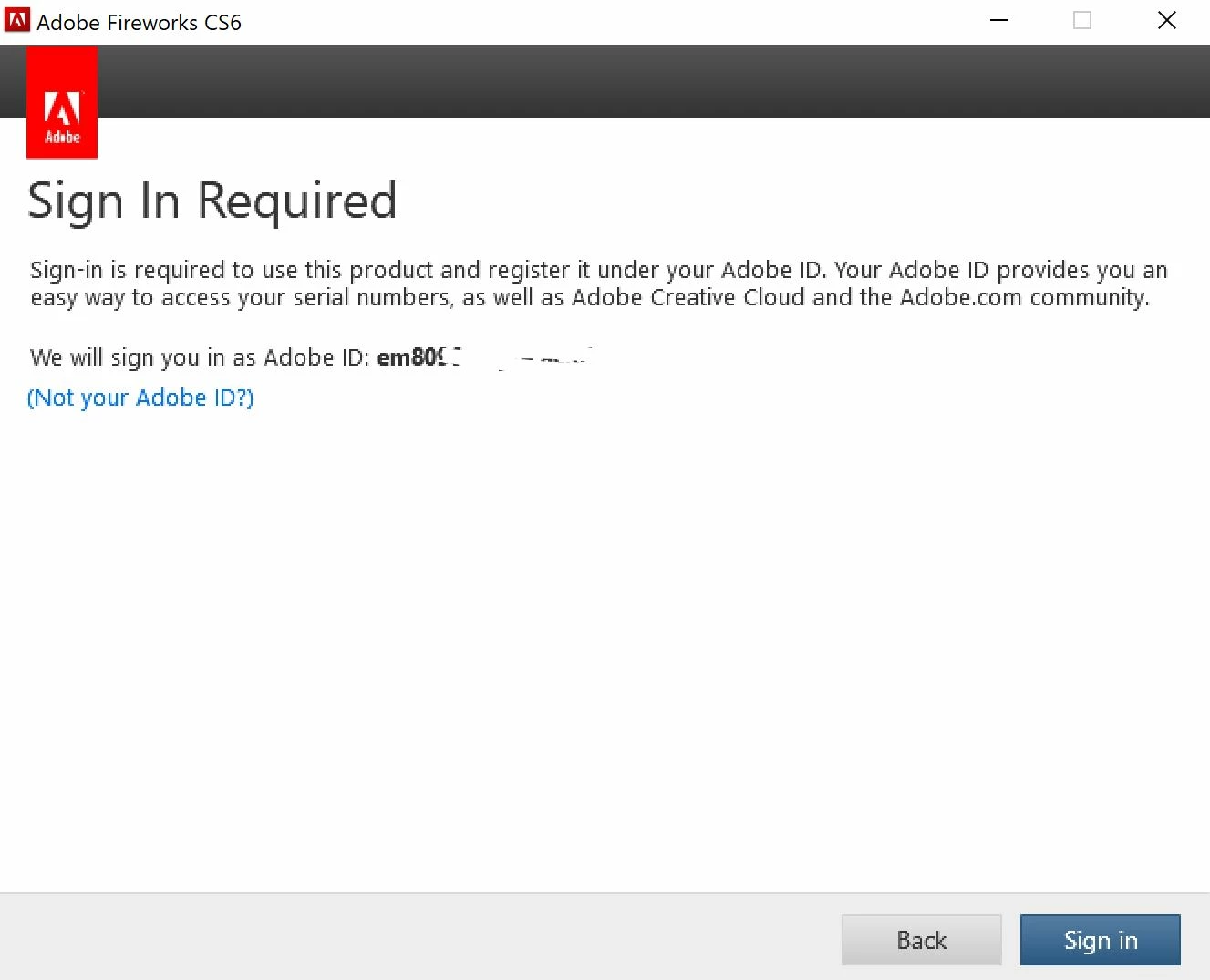

Aug 24, 2020 4:35 AM UTC
Try this: make sure Fireworks is closed, then go to the Creative Cloud app - top right, click your profile icon and sign out of Creative Cloud, now launch Fireworks you may get either a 'license this software' button and when you click it you'll be prompted to sign in or you will just get a sign in prompt. After signing in does this cure the issue? If not post a screen shot of the Fireworks window asking for serial and  can you state if you're on Mac or PC please.
Paul-M - Community Expert
Aug 24, 2020 5:09 AM UTC
Hello Paul,
Thanks for your feedback but unfortunately that didn't work. I am on PC and I have attached some screenshots.
Aug 24, 2020 5:50 AM UTC
Which order do they appear in? What happens when you click 'license this software' or the 'sign in' button? You are usig the correct sign in credentials I assume?
