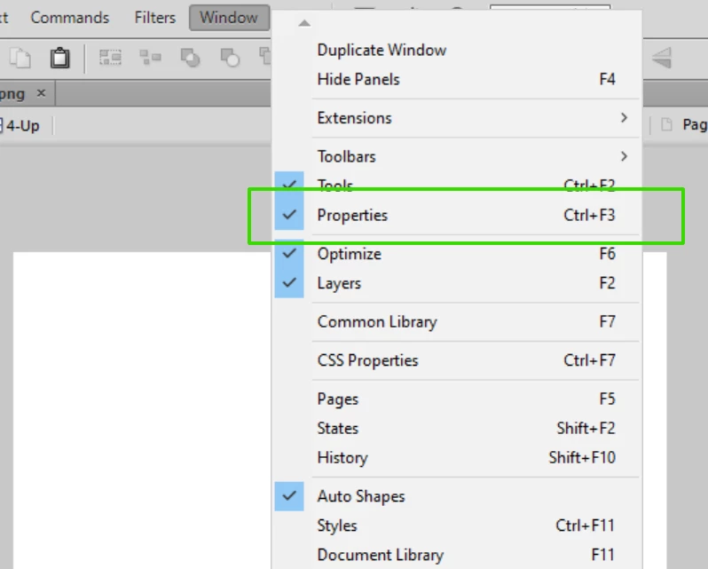

Hi all, I'm having an issue and hoping someone can help.  I've somehow managed to remove the properties toolbar on the bottom of my Fireworks workspace.  I've managed to find a kind of properties toolbar and it's there, but it's missing all the things I need like the X and Y axis and the size, etc. Does anyone know how to restore this?  I have no idea how I managed to remove it in the first place or I would try to simply undo my actions.  I have been hunting online to no avail and scoured every setting on Fireworks but just can't seem to find how to get this toolbar back.
    Paul-MCorrect answer
    Dec 8, 2020 3:31 PM UTC
    Hi Yvette - Do you mean the properties panel at the bottom? Have you tried from the top menu selecting window => properties

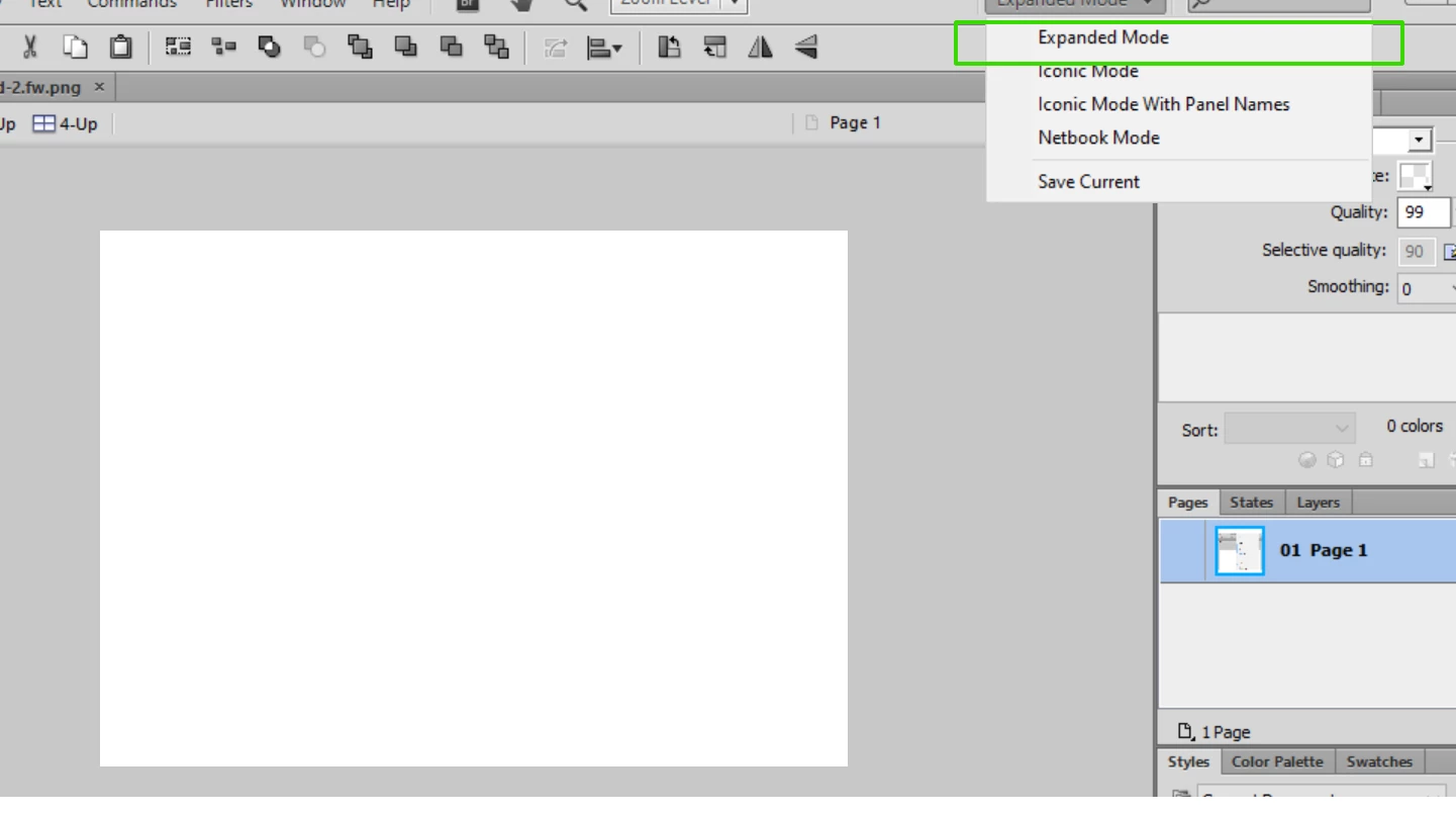

    You can also try resetting your Fireworks layout by selecting a predefined one like expanded mode, it should reset your panels:

    Thnaksd - had similar problem - un docked and could not get properties to re dock along bottom
    Setting to Expanded mode did the trick

    Thanks for that.  It's not quite the way it was, but I can now access the axis and size of objects much easier so thanks for that 😄
