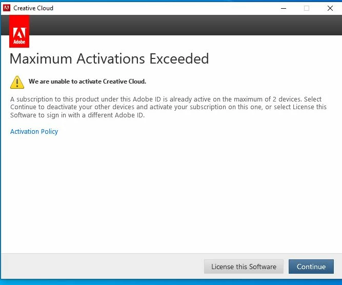

I have been using FW for a long time.  It is the easiest for me to make simple and quick changes to a .PNG file.
I am trying to open and getting a 'Limit Reached' warning.  I have signed out of all of the creative cloud seats manually at Adobe.com.  I close the app and re-open it and it does not recognize that I have signed out of all devices.  Then, it says 'Update Required'  It appears to be an Internet Explorer problem.  How do  I get around this as Microsoft wants to used Edge.  Please advise as we can not do anything at the current time with our project.
Thx
Luke
    Paul-MCorrect answer
    Aug 5, 2022 11:51 PM UTC
    I'm assuming you're on a Windows machine? This should fix your issue:
    1) Download the Adobe Creative Clouder Cleaner Tool from here
    2) Remove Fireworks by running the cleaner tool (run as administrator) => select language => agree to terms type'Y' => select 1. All => 2. Adobe Fireworks CS6
    3) Go to C:\Program Files (x86)\Common Files\Adobe\OOBE\ and rename or delete the folder 'PDApp'
    4) Go to C:\Users\username\AppData\Roaming\Adobe\ and rename or delete the folder 'CS6ServiceManager'
    5) Now open the Creative Cloud app and turn off automatic updates; click your profile icon (top right) => Preferences => Apps => make sure Auto-update is off (if you leave Auto-update on, Fireworks will be updated and you'll most likely end up with the same issue again).
    6) Reboot your system for good measure
    7) Download this offline Fireworks installer that I saved , unzip it and install Fireworks **NOTE** Choose 'TRY' when presented with options, you may additionally be asked to sign in with your Adobe credentials
    😎 When you launch Fireworks for the first time, you may be prompted to sign in with your Adobe credentials, if you then see a button 'license this software' click it, and you should be good to go.

    So, Paul-M.
    I followed the steps exactly.  Rebooted.  Attempt to sign in and get the same results.  I am able to sign into Adobe.com and see that I only have one activation on my computer at home.  If I am correct, I am allowed two simultaneous logins?  I am now locked out because I have attempted to login a number of times.

    Aug 6, 2022 9:21 PM UTC
    Thank you for these detailed instructions. I was able to get all the way to the end, however when I select 'license this software' I am asked for a serial number. But I don't think I have a serial number because I originally licensed through Creative Cloud. When I try the option to sign out of other devices, it says I am not using the Adobe ID associated with the product. I also verified in my Adobe account that I have only one device listed as authorized, even though the error message keeps insisting that I have authorized more than two. This is all so strange, it all used to work fine until very recently. Any additional ideas would be greatly appreciated!
