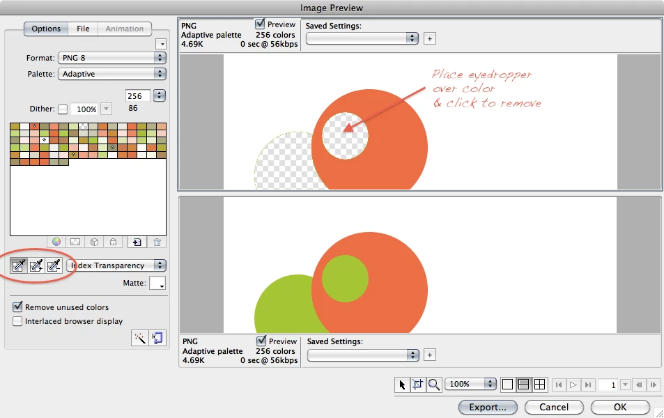

    There is another way to convert color to transparency in FW, but it requires exporting a graphic as either a GIF or PNG-8—which are both indexed color formats, suitable for flat graphics but not so great for photos.
    Use the Optimize panel and a Preview mode (such as 2-Up), or choose File > Image Preview...,  as shown. Once you choose the GIF or PNG-8 format, several eyedroppers will appear beneath the palette area. Choose either the "Select transparent color" or "Add color to transparency" eyedropper, and place your cursor over the color you wish to make transparent, then click. You may notice some aliasing around the edges; to fix this, you can zoom in and continue to add colors to transparency. It's probably not the best method, but it is an option.

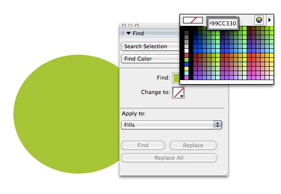

    Initially, I thought you might have been referring to the Find panel, which is useful for replacing colors with vector objects. It, too, lacks support for transparency. There is a trick you can do to force the transparent (or "None") swatch to appear: In the hex code input of the Color Picker, add a "0" to the end of the 6-digit hex code. The problem is, this won't actually work to replace the color with transparency; once you try to apply it, the color reverts to its previous value.
