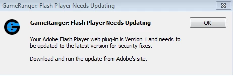

The problem is, I cant run Gameranger.  When I launch it, it says:
Gameranger: Flash Player Needs Updating.
Your adobe Flash player web plug-in is Version 1 and needs to
be updated to the latest version for security fixes.
Download and run the update from Adobe´s site.

    That's a 100% a GR problem. Here's what it is.
    GR, like a lot of websites, uses a detection script to determine the presence and version of Flash Player. A lot of older websites haven't updated their scripts in a while and GR is the same way. Older "detection" scripts are based on a one (1) digit version number for Flash Player. 1 is 1, 2 is 2... 9 is 9... BUT  10 is 1 again, and so is 11, 12, or 13 according to the detection script.  I'm pretty sure you still had version 9 when you installed it, but have since updated to a 2 digit version, and that's what's causing this.
    Since the message you're seeing specifically mentions version number and NOT a missing Flash Player, it can't be that you needed ActiveX and didn't have it. You DID and do, and a version higher that 9, but GR's script can't detect a two digit version of Flash Player.
    You can try a "clean install" of Flash Player (http://forums.adobe.com/message/4041846), but since the problem comes from GR... I don't think it'll help.

    No... the scripting is in the pages or app.  Windows 8 embeds the ActiveX plug-in, and it's modified by Microsoft after Adobe writes it. That's probably why it works, where it won't with Win7, Vista or even XP.
