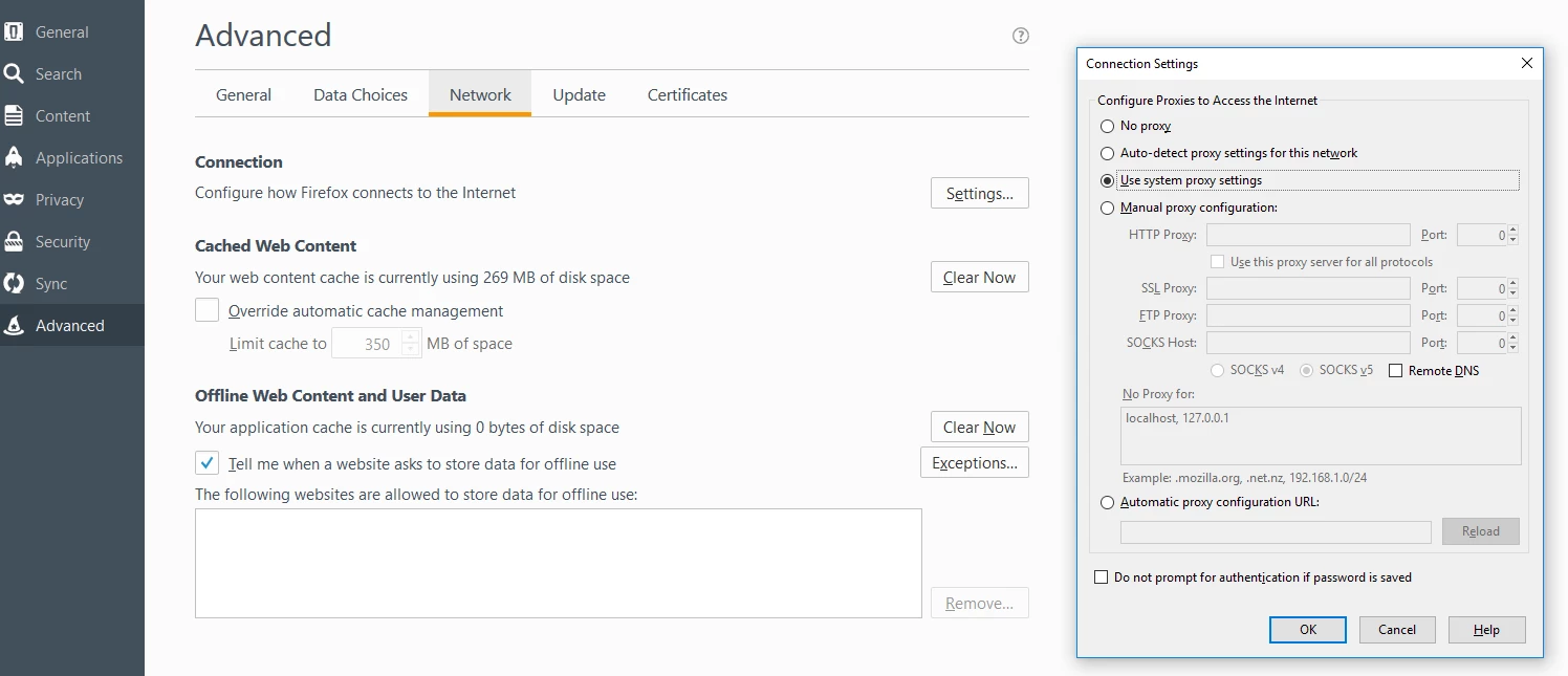

Do you have a proxy set up in Firefox?
That is under settings - advanced - network - then click the 'settings' button next to connection.
Mine is set to use system and has nothing in the manual settings fyi I did see something about a proxy in one of those logs.
