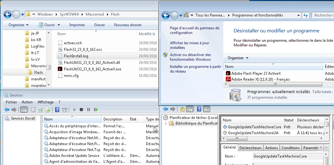

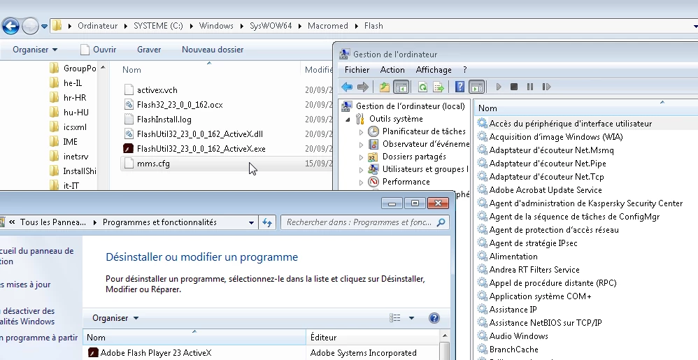

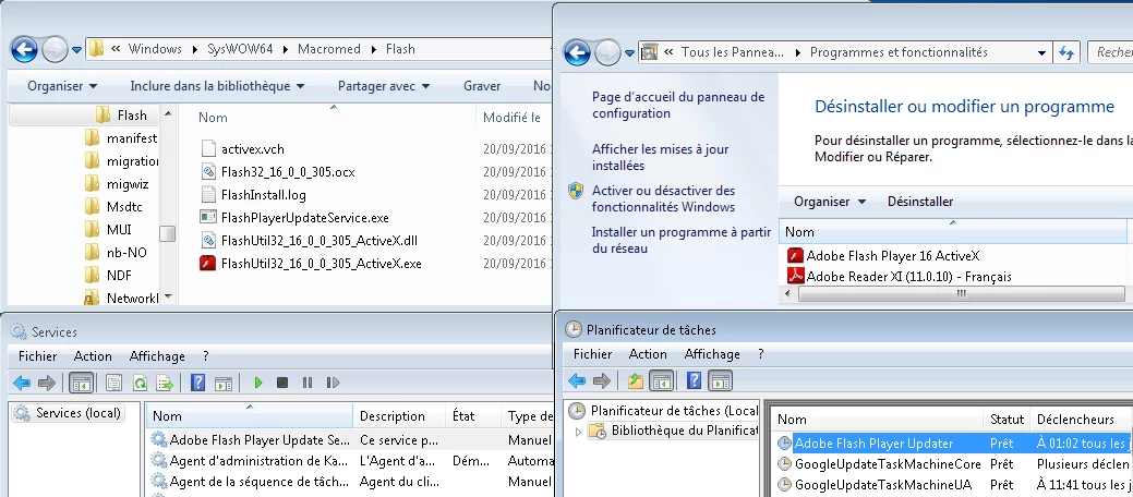

Ok, here are the steps I'm doing to reproduce it :
  1. My test computer is now clean of any version of Flash Player, i've also deleted C:\Windows\SysWOW64\Macromed\Flash and C:\Windows\System32\Macromed\Flash folders, and registry key HKEY_LOCAL_MACHINE\SOFTWARE\Macromedia
  2. I've disable Kaspersky Endpoint Security 10 antivirus,
  3. Manually install install_flash_player_16_active_x.msi, everything is ok (file, service, task,...)
  4. I create mms.cfg file under C:\Windows\SysWOW64\Macromed\Flash with these parameters
    SilentAutoUpdateEnable=1
    AutoUpdateDisable=0
    SilentAutoUpdateServerDomain=srvsus01.hopital-saint-joseph.fr
    SilentAutoUpdateVerboseLogging=1

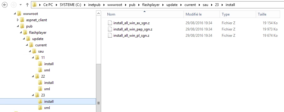

  5. Our Background Update Server is on a IIS web server, anonymous access on,
  6. I start the update task manually, and same problem .exe disappear after a while (3mn)
  7. Here is the complete FlashInstall.log
