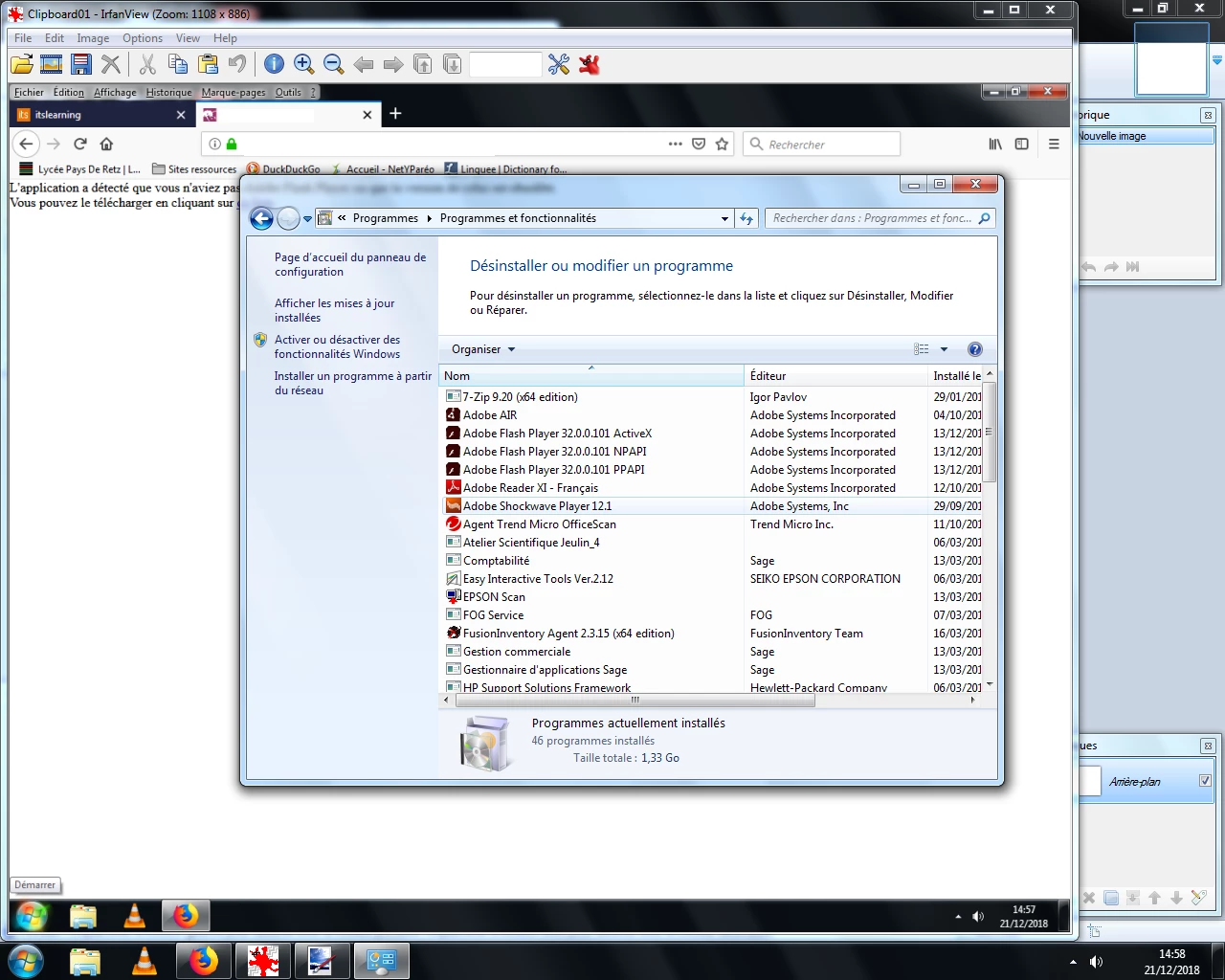

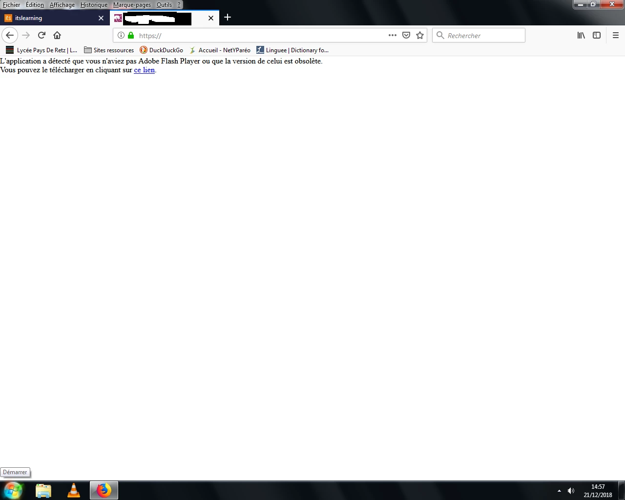

    Here included 2 pictures (screenshot from today  2018-12-21)
    - Firefox complains of not finding Flash
    - Flash is really installed on the computer
    And when asking Firefox to display the list of installed plugins and extensions, flash does not appear.
    (meanwhile is does appear in this kind of list on the computer I am using at this moment to write this message)
