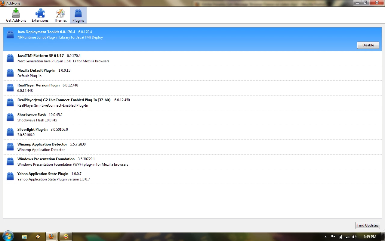

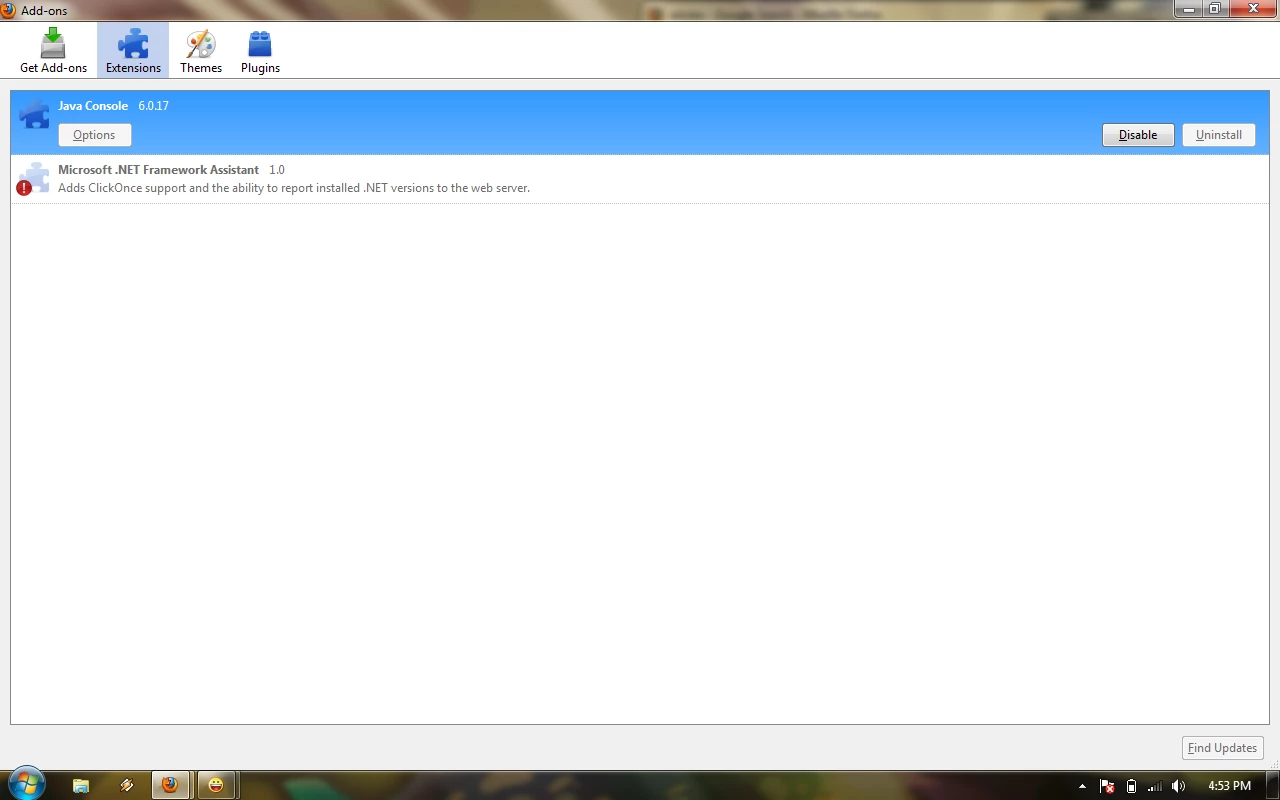

So ive recently have started having problems with my computer where i will be watching a video clip and after a random amount of time the video will just freeze then i my browser stops responding.  I have to use task manager to kill the browser and when i start surfing the web again i can do everything except watch videos.  The only way i have found to fix this problem is to reboot the computer and just hope that i can finish watching my show before it freezes again.  I very strongly believe that it is flash because it only does this whenever there is a video clip being played.  Ive also narrowed this down thinking that it was my computer registry or something so a few nights ago i did a format and then a clean install of windows 7 64 bit.  Ive read that sometimes it is the antivirus software that causes this so when i reinstalled my os i didnt install any virus protection yet, before i was using avg though.  I usually use firefox 3.6 when using the web but ive noticed that it crashes in IE and chrome.  Ive included a screen capture of my extensions and plug ins for firefox to help out, anything else you want to know you just ask.

    If you are using Win7 then you have IE8. You may want to go into the Add ons(all) and find Shockwave Flash Object and see that it is enabled and note the version.
