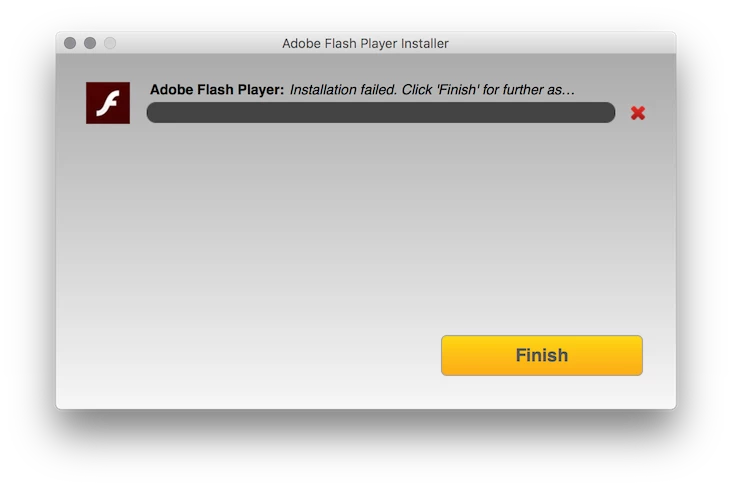

Can't install latest flash player MacOS Sierra GM
The title says it all. Can't install version 23.* Tried uninstalling also before install with no luck.
Any Thoughts?
TIA

The problem you are not able to install Adoble Flash PLayer on macOS Sierra is because of SIP (System Integrity Protection) which is preventing the app to write on the directory /var/folders/...
To solve this you have to enter Recovery Mode of Mac. To do that, restart your mac and press Command + r to enter on recovery mode. After loaded recovery mode, go to the menu and select terminal. On terminal enter the following command line:
csrutil disbale
After that, enter reboot to enter normal initialization. Now you will be able to install Flash Player. When finished installation, do the same procedure to enter recovery mode and enable again the SIP:
csrutil enable and then reboot

You can get the latest Flash Player from Adobe Flash Player Install for all versions ​. The issue has been fixed.

Sep 13, 2016 1:44 PM UTC
I use Firefox 48.02 most of the time. I also use Chrome 53.0.2785.101 and Safari 10.0 . The issue is the installer fails with the error "Installation Failure" with no browser open.
