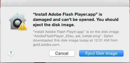

Downloaded installer corruptedI
OSX version: 10.10.5  Mac Pro
Safari version: 10.0.3
Currently installed Flash player: 24.0.0.194
I've attempted to download and install the latest update multiple times.  Every single time it says the file is corrupted and should be ejected and does so without installing.
What should I do?  Is it possible the file on the server is corrupted?  Is my setup somehow interfering?   There is no stored website data in safari or Flash in all the possible locations I could find to check and delete.

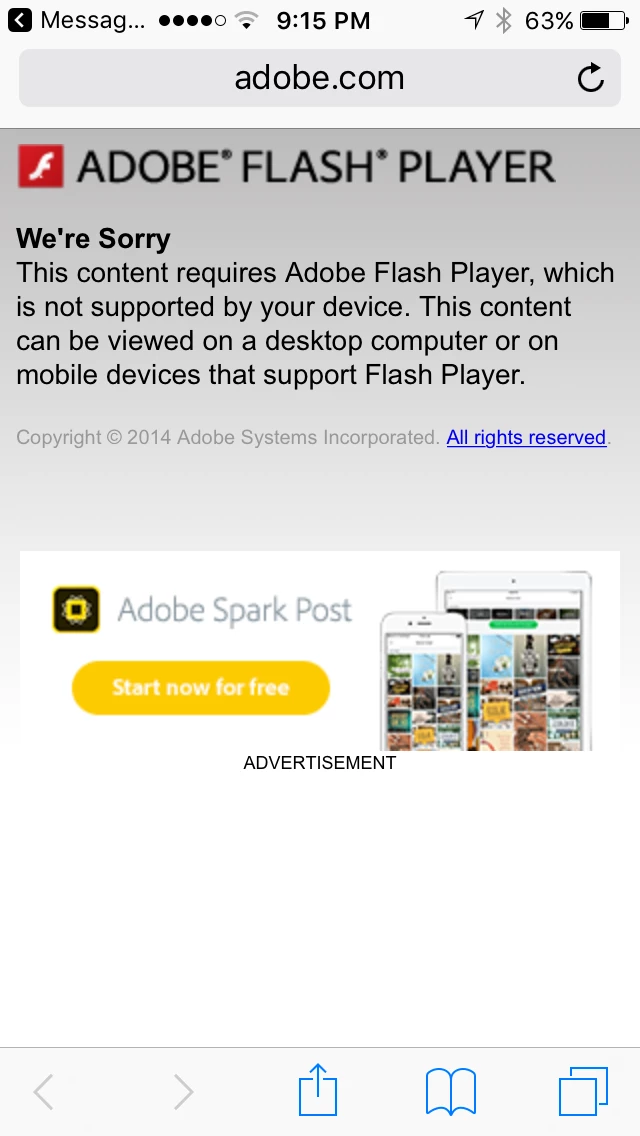

    Apr 20, 2017 11:24 PM UTC
    Sorry mvargas but on both my iPad and phone I'm unable to download the installer because it says "this page requires flash to view."  I'm paraphrasing as I don't recall the exact message but that's the gist.  I can send you a screenshot from both.  If I wasn't receiving that message I'd be able to continue installing by downloading using my phone, park the download on DropBox then install the Flash update installer DMG from my Dropbox folder.  That process has worked in the past for me.  It doesn't any more because the update download page says it requires flash to view.

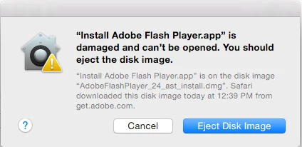

    JiJoBoJaJa
    Apr 6, 2017 6:44 PM UTC
    Thank you for the prompt response.  I'm sure my lag in response has contributed to you missing it in the first place.  I'm so busy it takes me a while to circle back to such stuff.
    Tried your suggestion of downloading from the "Still having problems" section and same result.  See attached error message I received.

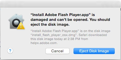

    JiJoBoJaJa
    Feb 21, 2017 5:42 PM UTC
    Thanks for the reply.  Tried that link and same result.  Attached screenshot of error.
    Any ideas on what's causing this?
