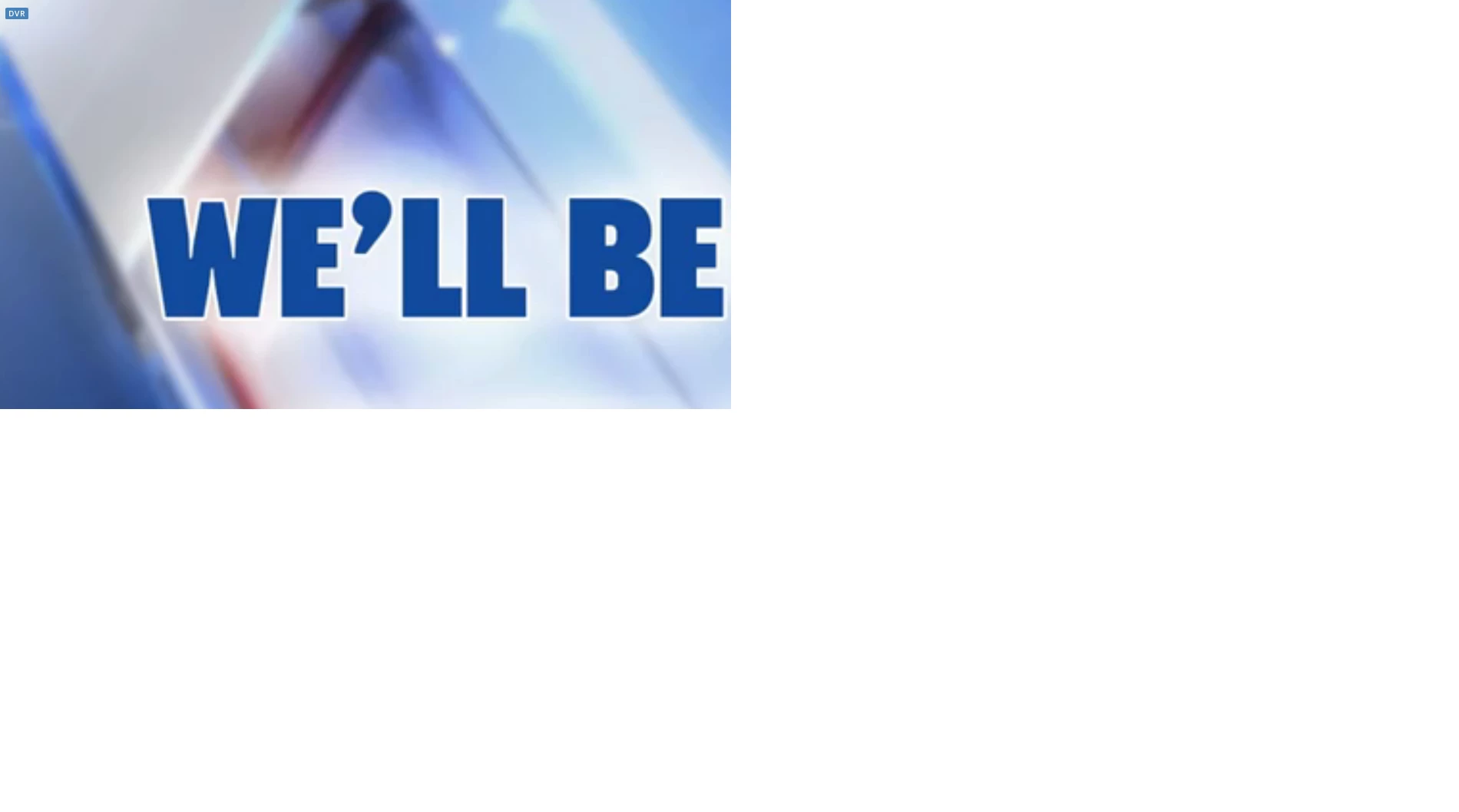

Now, on version 23, on fullscreen on an external monitor, it no longer shows the full picture for full screen, it shows a corner and the rest is white. I can play and pause in the "not working" areas but I just can't see anything. (Picture included)

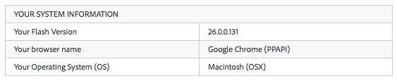

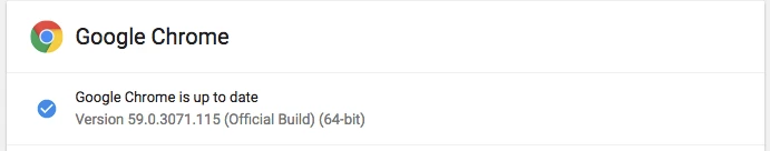

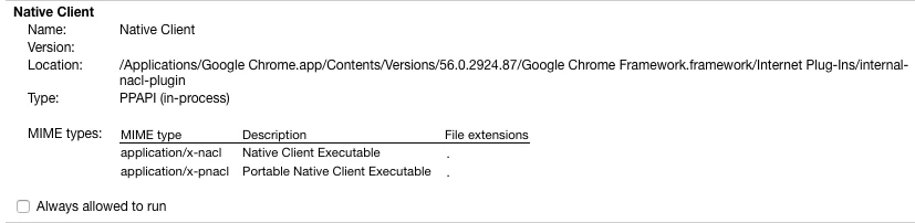

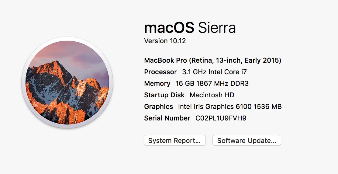

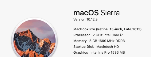

jackiesoo
Jul 8, 2017 9:51 AM UTC

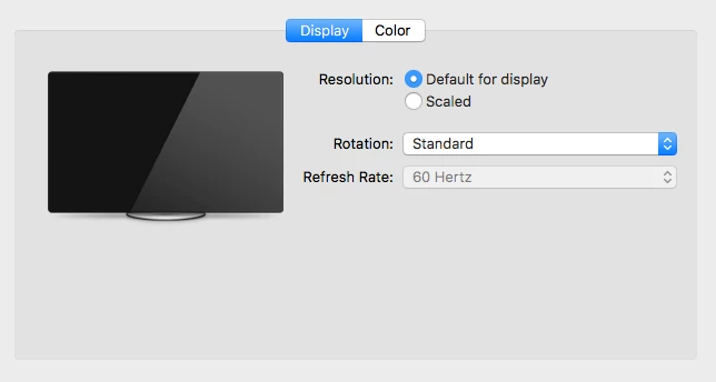

Still having the problem. The external screen is not the problem as I tried on 2 screens and 1 TV.
Here are mine:

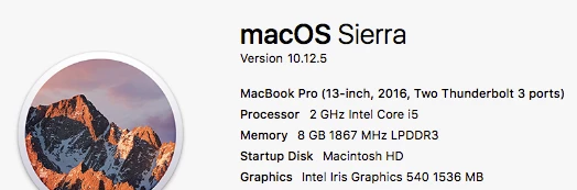

Jul 19, 2017 1:37 PM UTC
I am also having the same issue on my MacBook Pro with Sierra. Any updates on solutions or workarounds (other than using FF)?

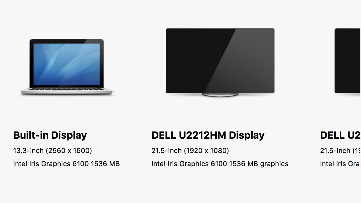

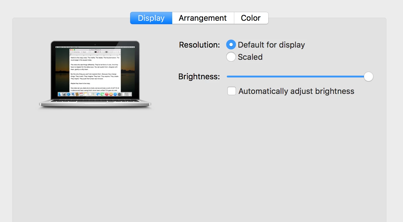

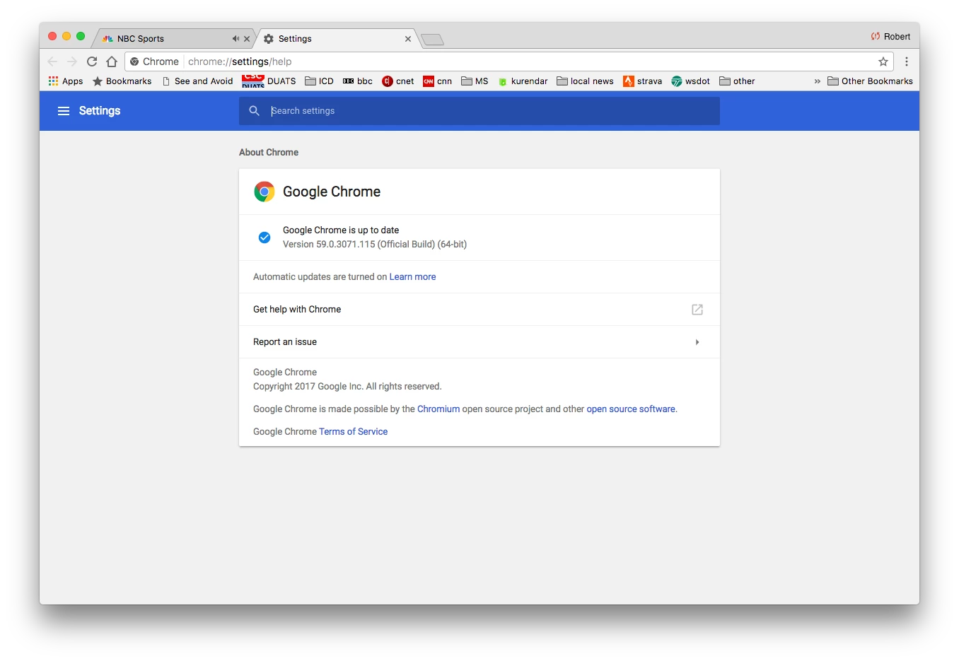

sydneymakers
Mar 7, 2017 9:53 AM UTC
Hello Everyone.

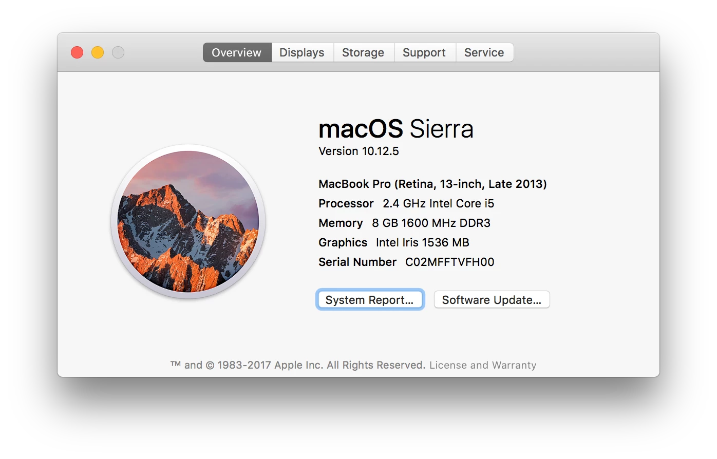

I am using a MacBook Pro with the following specs:

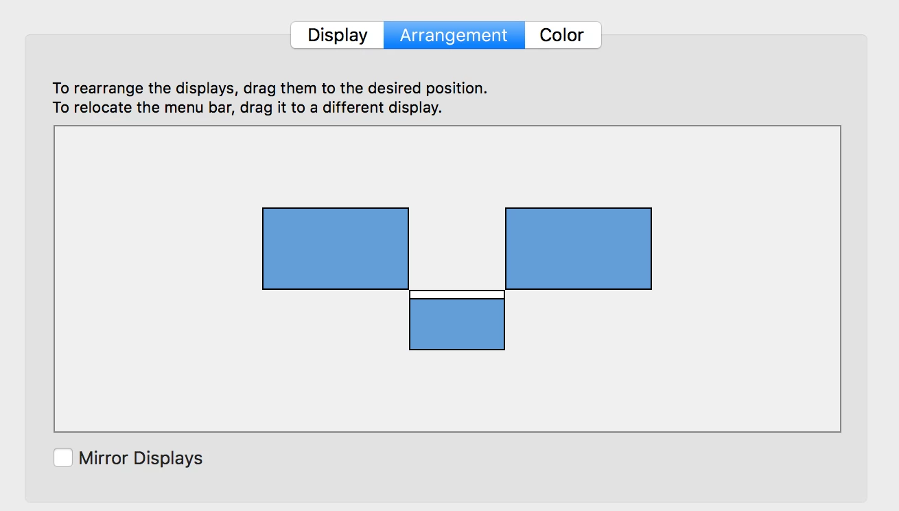

This is the screen setup, both external displays are the same, both experience this issue.
They are currently connected to the thunderbolt ports of the MacBook Pro
This is the arrangement, with external screens in the top corners.
The secondary screens both have this setup
The main screen has this setup:

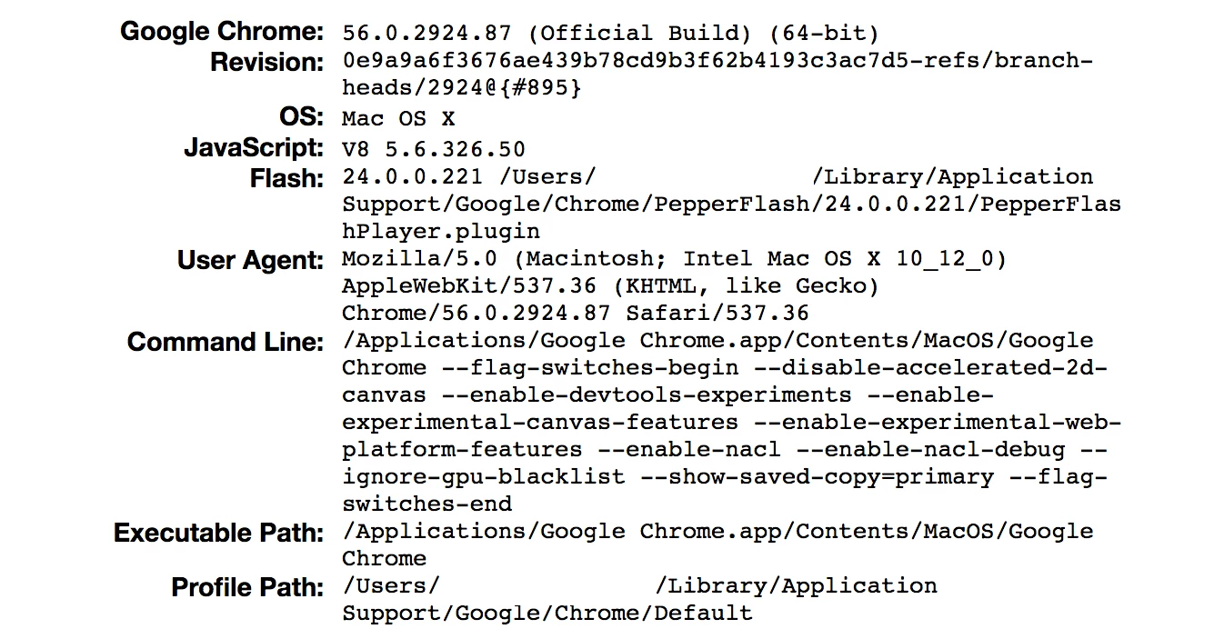

This is the chrome://version page:
Finally, it is worth noting that I experienced this graphics bug while the video player's Right-Click-> Settings -> Hardware acceleration was both enabled and disabled with full browser restarts after toggling it.
However, going to the chrome://settings -> "+ Show Advanced Settings" -> System -> Hardware Acceleration and disabling it there, then restarting chrome DID fix the issue.

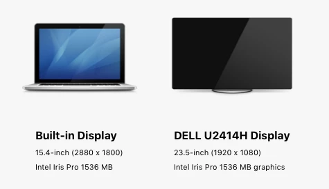

hello, just wanted to let you guys know that I dont think it's an issue with significantly lower monitor resolution.
I have the same issue on a mbp (MacBook Pro (Retina, 15-inch, Mid 2015, GPU: Intel Iris Pro 1536 MB) and 27" monitors (dell if that matters) with 2560 x 1440. Although the mbp has the retina resolution of 2880x1800 one of my monitors is almost new and has no problems other than this bug
for me this problem only occurs in chrome and not on FF. Something google did in late Q3/Q4 I think introduced this bug
