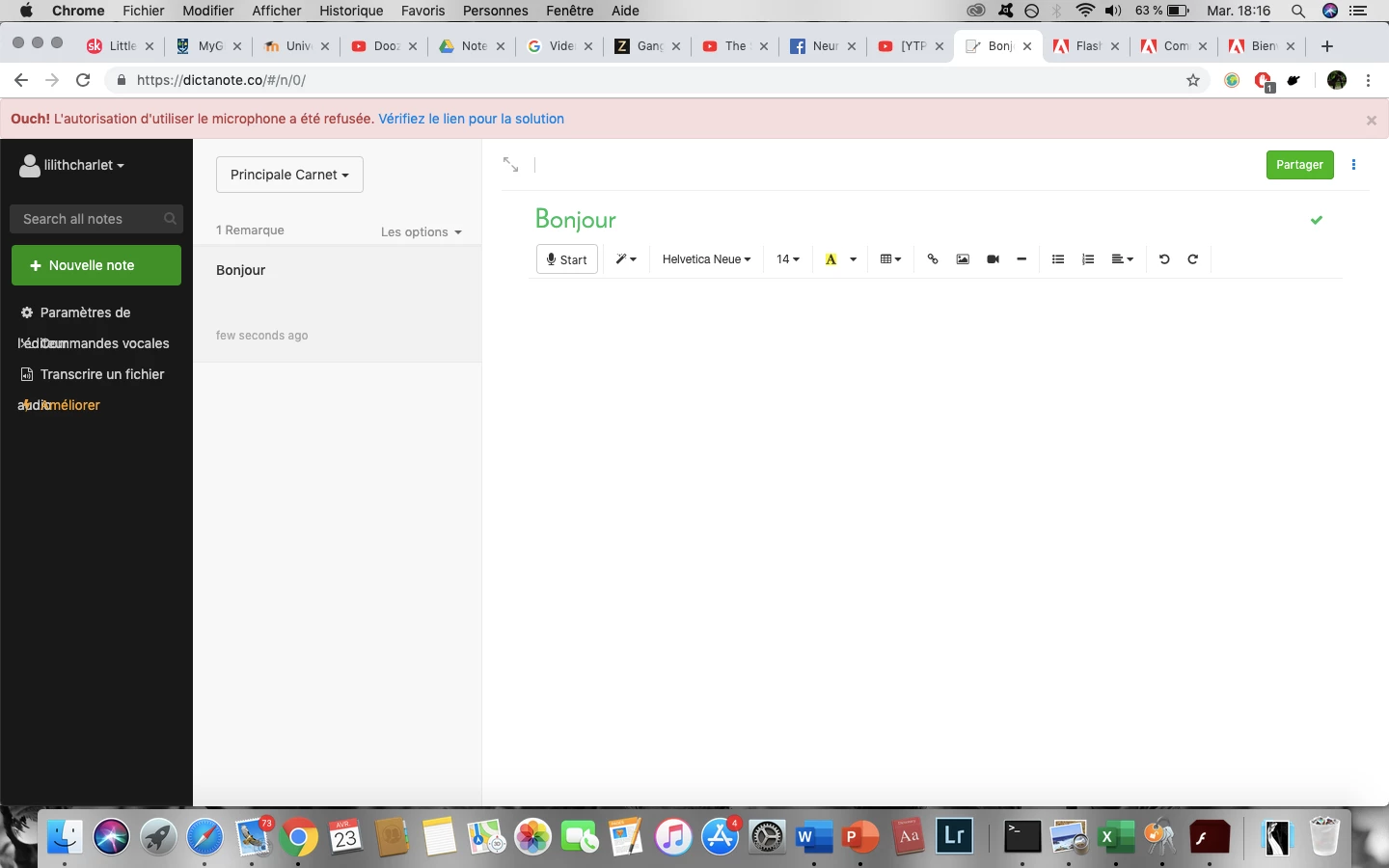

On this website, I'm trying to use my mic. Here is what happens whenever I'm trying to use it (the message means "The authorization to use the mic was denied") :
Now, it is the same on facebook, and the same on any website in Safari. However,

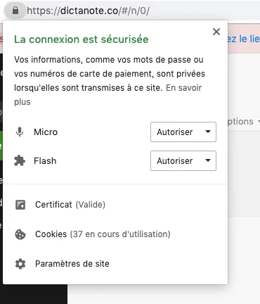

          1. I have activated my mic AND flash on the website (cf. pic)

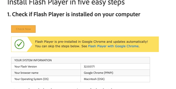

          2. I have downloaded the last version of Flash and it says that it's activated

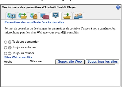

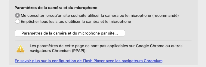

          4. I tried to go on Flash Settings, but no website appear on my list, and no authorization is asked when I try to use the mic.

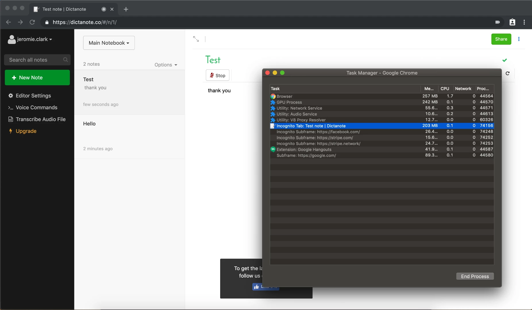

Also, as far as I can tell, Dictanote isn't using Flash.  See the Chrome Task Manager screenshot below.  You should talk to Dictanote about the technical issue you're experiencing.

Agreed.  What I'm saying is that it's not Flash.  In the instance you provided, Flash isn't even in play -- the website is using the browser's native audio facilities, but it's not working.
Your microphone doesn't work in the browser.  If it doesn't work in the browser, it's not going to be available to Flash.
