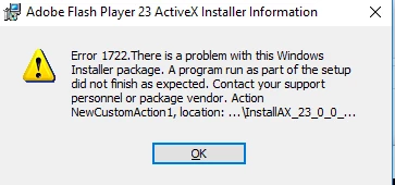

I downloaded the "distribution" MSI to push it out to devices in my Enterprise.  the NPAPI installer works just fine, but the ActiveX installer is failing regardless of whether I run it as an administrator, run it manually (GUI), or run it silently.
The same error appears in the installation log every time I run it.  The exit code returned is 1603, but scrolling up in the log reveals it's a problem with "NewCustomAction1".

I get this error when I run through the GUI:

Hi peterl6648231 ,
As of Windows 8, Microsoft embeds Flash Player ActiveX Control in IE and Edge browser on Windows 10, and all Flash Player ActiveX Control updates are released by Microsoft via Windows update.  The Flash Player ActiveX installer will not install Flash Player ActiveX on Windows 10 system.  The EXE installer displays a message stating this immediately, but it looks like the MSI installer isn't doing this, and instead fails with a generic error.  I'll file an internal bug to fix this behaviour.
Also, the distribution page, where the MSI installers are posted to, includes a note stating the ActiveX Control is not for Windows 8 and above:
Maria
