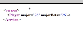

The other errors indicate the request to the currentmajor.xml file failed.  Using a browser, please attempt to view the locally hosted currentmajor.xml file (e.g. launch browser, navigate to https://your.domain.com//pub/flashplayer/update/current/sau/currentmajor.xml).  Does the page display?

I have access to currentmajor.xml and i can navigate to the whole Folder Structure
I get no Certificate Issue. This is the Content of the File:
