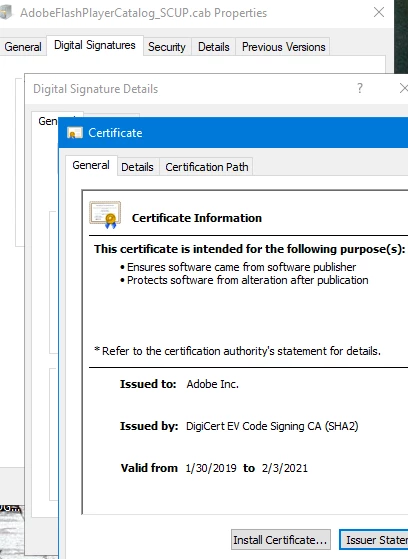

Apr 15, 2019 6:12 PM UTC
This is a big mess,
I've been fighting this for a few days and have insecure clients on my network, Adobe peeps, please provide steps to get through this issue, I've removed this subscription, synced, subscribed numerous times and am still unable to publish the content.
I had no issue publishing this months Acrobat and Reader updates, it's just Flash that is giving me problems.
P.S. I am authorized to redistribute Flash, Reader, and Acrobat updates.
Thanks in advance!

_maria_
Apr 16, 2019 5:34 PM UTC
Can you try changing the PublisherID to just Adobe?  While the certificate has Adobe, Inc, the VendorName in the SCUP catalog is just Adobe.

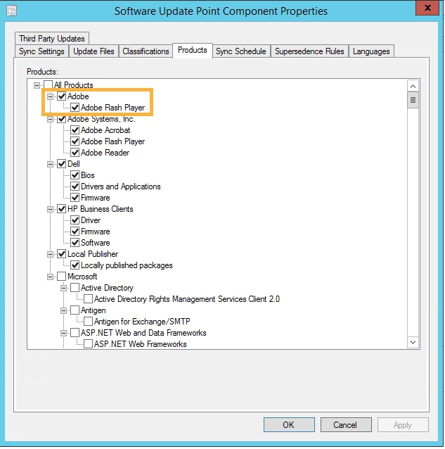

Apr 10, 2019 1:43 PM UTC
I am also experiencing an issue syncing new updates. We are trying to push the latest version in response to APSB19-19 but we are not getting the most recent version of the product. I see the previous versions have been expired but nothing new has ben synced.
bobs85008685
Apr 10, 2019 2:06 PM UTC
For my particular issue, I think I'm missing updates because Adobe decided to change the publisher name from Adobe Systems, Inc. to Adobe. I just selected that in my SCCM Update Point and am currently re-syncing my catalogs.
bobs85008685
Apr 10, 2019 2:13 PM UTC
Yes. This worked. If you're not seeing the new updates, since March 2019, make sure you've added the new publisher.
Apr 10, 2019 1:41 PM UTC
Ok everyone, I did find the solution. While adobe fix there certificate, we need to enable it. When you do the first sync, you will have an error in the third party sync view (I'm with SCCM SUP with Third Party Enabled on 1810).
Go to Administration ==> Certificate and unblock all Adobe Certificate
After, go sync all third party catalog again. If it still fail, unsubscribe and subscribe again to get a new certificate and be sure it's unblocked.
After the sync finish, initiate a software update sync. It's going to take sometime.
Now, adobe changed something again. The flash player are no more under Adobe Systems, Inc, but now under Adobe. Since it's a new entry only available after the succesfull sync, you need to add it to the sync. Go in administration ==> Sites ==> Manages Software Update Point ==> Products ==> Check the new Adobe / Adobe Flash Player.
Sync again, now they're present...
ciprianm18057411
Apr 10, 2019 2:10 PM UTC
Thank you very much.
Checking the new Product category in SCCM for Flash Player, finally managed to make them available in All Software Updates.
davidm43001574
Apr 10, 2019 2:21 PM UTC
That did the trick, thank you! I knew the name had changed, I just hadn't considered that it might have also changed in SUP. Appreciate the assist.
