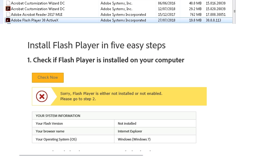

    prakashk25493150
    Aug 10, 2018 7:33 AM UTC
    Hi Jeromie,
    Below is the result of the flash player test.
    Tried to disable Shokwave addin and enable it again but there is no change.
    jeromiec83223024
    Aug 10, 2018 4:48 PM UTC
    From your screenshot, it looks like Flash Player is installed, but it isn't getting invoked by the browser.  If this is an enterprise machine, you may have a GPO deployed that is preventing Flash Player from running.  If it's a standard Windows installation on a home network, it's typically because you need to change the ActiveX filtering settings.
    Did you follow the steps in the guide above for enabling Flash Player in Internet Explorer?
