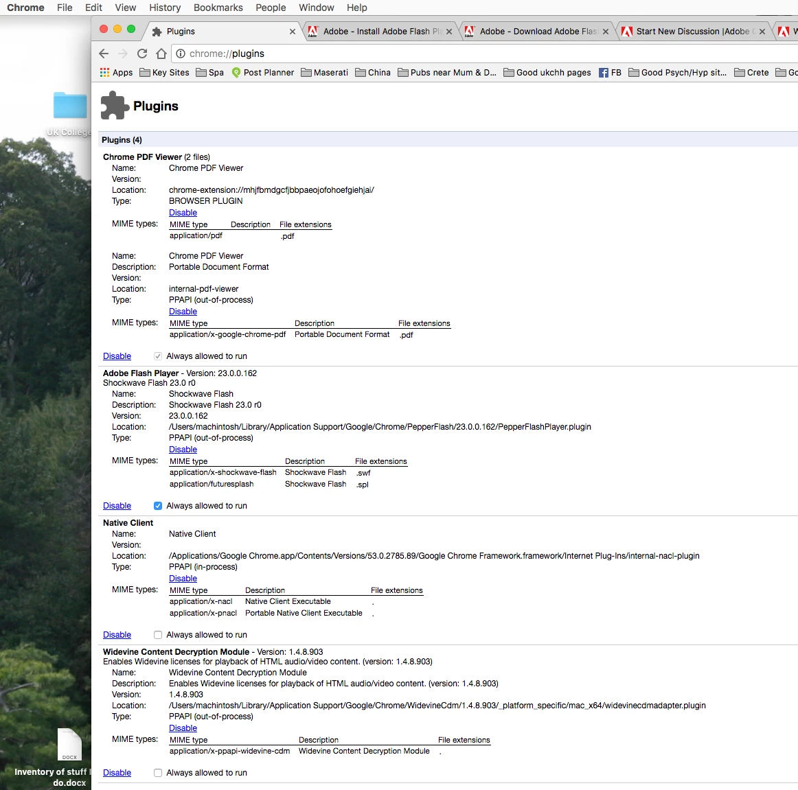

a) Chrome keeps showing
Adobe Flash Player - Version: 23.0.0.162
Shockwave Flash 23.0 r0
Description:Shockwave Flash 23.0 r0
Version:23.0.0.162
Location:/Users/machintosh/Library/Application Support/Google/Chrome/PepperFlash/23.0.0.162/PepperFlashPlayer.plugin
Type:PPAPI (out-of-process)

However Chrome is still not working. Despite uninstalling and then reinstalling version 22 - the listing in chrome://plugins/ is for this bizarre 23.0 r0

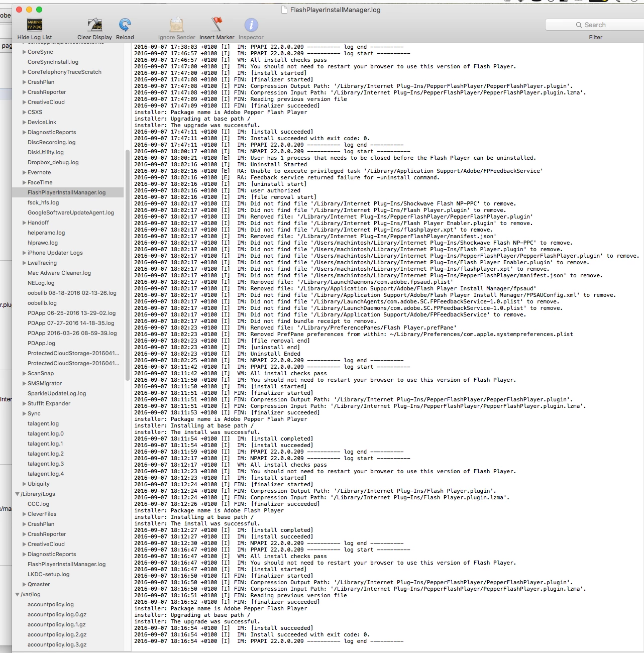

Here is the install log - you can see I've been busy trying to figure this out. But the last PepperFlash install looks good and is version 22.
Where does version 23 come from??

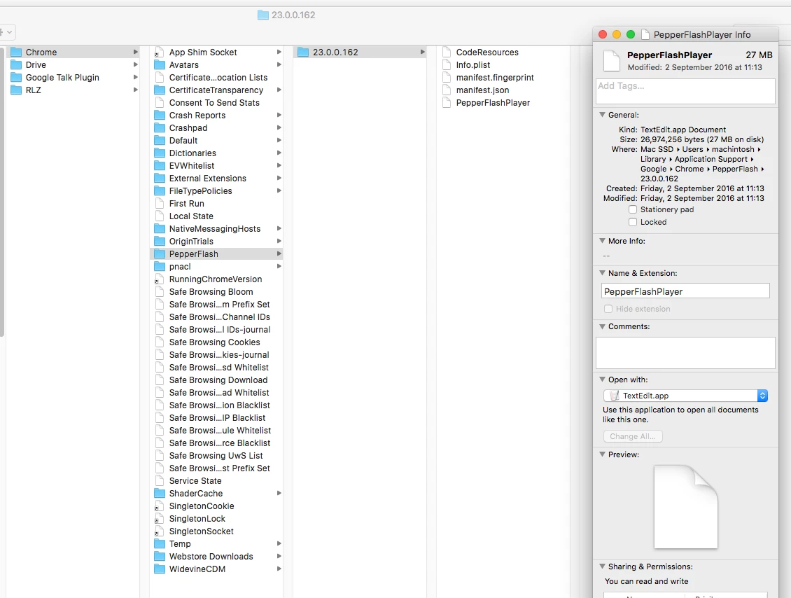

Can you please launch Finder and navigate to /Users/machintosh/Library/Application Support/Google/Chrome/PepperFlash/23.0.0.162.  What is the full name of the PepperFlashPlayer file as it appears in the directory?  If file extensions do not display, see OS X Yosemite: Show or hide filename extensions  to display them.
Safari and Chrome use two different plugin types.  Safari uses NPAPI plugin and Chrome uses PPAPI plugin.  Google embeds Flash Player in Chrome.  The PPAPI version downloaded from adobe.com is not used by Chrome.  If you didn't install the NPAPI plugin previously it's why Safari didn't display the Flash Player plugin.
Sep 7, 2016 11:24 PM UTC
Hi
Thanks for looking into this.
It is simply PepperFlashPlayer - with no file extension.
