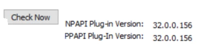

    Thanks for posting the screenshot.  Both of those are the most recent version of Flash Player, so it's odd that you keep getting prompted to install Flash Player.
    The NPAPI Plugi-In is for Firefox and the PPAPI Plug-In is for Chromium-based browsers (e.g. Chrome, Opera).  They aren't interchangeable.  If you only use Chrome, there is no need to install the PPAPI Plug-In separately as Google embeds Flash Player in Chrome and releases updates to the embedded version.
    I would perform a complete uninstall of Flash Player, reboot the system, then install Flash Player NPAPI plugin for Firefox, in the following order:
    1. Download the uninstaller
    2. Download the NPAPI Plug-in installer (using Firefox, go to https://get.adobe.com/flashplayer)
    3. Close all browsers and apps that may use Flash Player
    4. Run the uninstaller downloaded in step 1
    5. Reboot the machine
    6. Run the NPAPI Plug-In installer downloaded in step 2

    Apr 1, 2019 2:14 PM UTC
    It sounds like you have more than one Flash Player type installed (Flash Player for different browsers) and one of those is the prompting for installation.
    1. Please to go Control Panel\All Control Panel Items.
    2. Click on Flash Player to launch the Flash Player Settings Manager
    3. Go to the Updates tab.
    4. Post a screenshot of the Updates tab.
