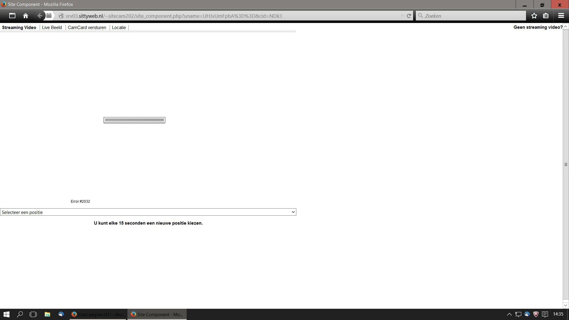

I just updated the Adobe Flash player to 18.0.0.232. This was the first Flash Player update since I installed Windows 10 a few days ago. Now I get the error code 2032 when I go to watch a streamed video feed like http://srv03.sittyweb.nl/~sitecam202/site_component.php?uname=UHJvUmFpbA%3D%3D&cid=NDk3 in my default browser Firefox version 40.0.
Earlier today I checked the same feed with the prefious version of the player 18.0.0.203 and firefox 39.0.3 and that worked just fine / as expected.
I have tried to reïnstall the 18.0.0.203 version of the Flash Player, but then got the same Error 2032.
Any Ideas on how to fix the Error 2032?

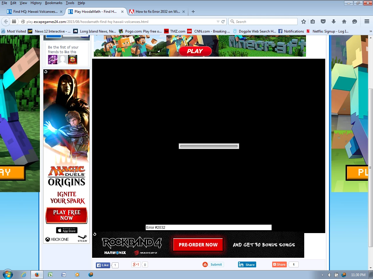

I'm totally stuck on where to find the about:config part.  I found an About area under HELP in Firefox but no config area.  I'm also getting this error across all browsers.  I've cleared all caches, reinstalled Flash, refreshed Firefox... nothing worked.
pwillener
August 23, 2015
You type about:config into the address bar.
August 23, 2015
Thank you for the reply Pwillener.  I tried changing the setting to false, but still no luck with getting the flash working.

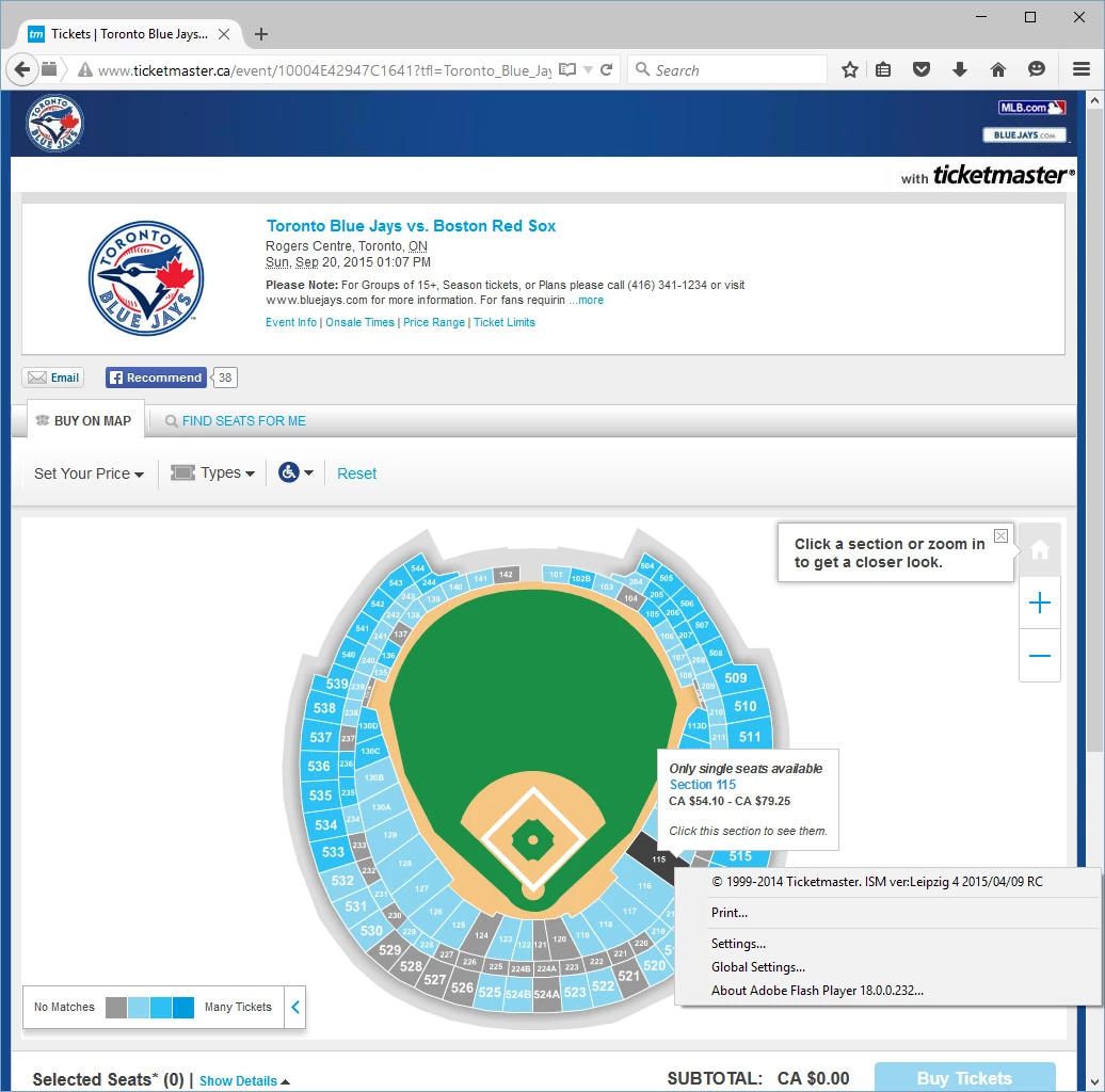

We just started getting this error (2032) as well with our Flash app and the 18.0.0.232 update. We're seeing 2032 across all browsers: IE (11.x), FF (40.0.x) and Chrome. Disabling ActiveX, as suggested in other links, makes it worse. For me personally, Windows 8.1 with IE 11.0.9600 does not work, but FF 40.0.2 and Chrome 44.0.2403.155 m do work.
Has anyone successfully contacted Adobe paid support for help with this?
