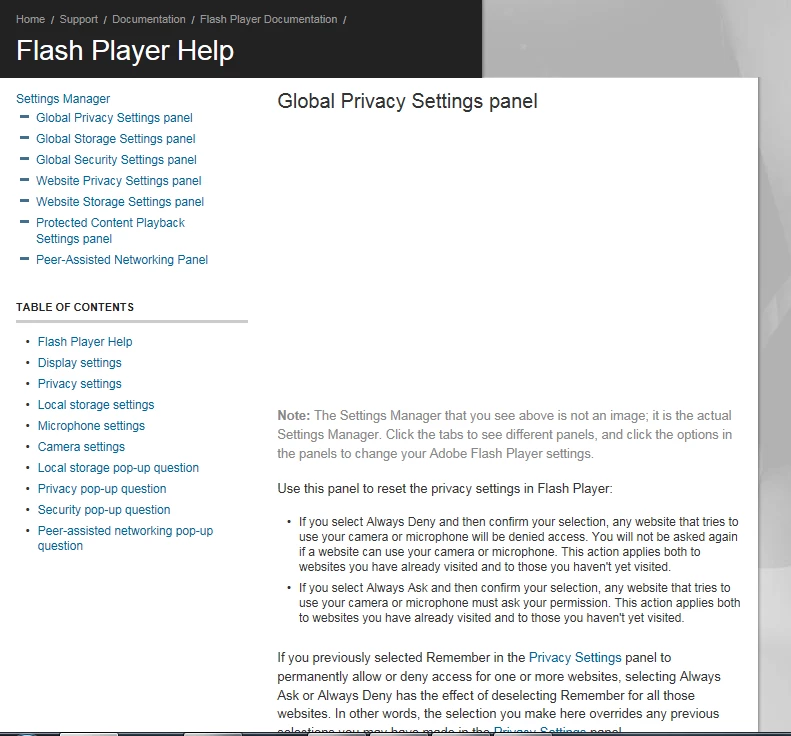

    Here's another thing (clue?) that's interesting... when I go to the Adobe page that allows you to adjust your settings, that image that has the settings is not there.  This page.
    Adobe - Flash Player : Settings Manager - Global Privacy Settings Panel
    Screen-grab below:
    It doesn't make sense.  As I said, that one link with the clouds moving worked and it read my IE as having the updated version installed. But why wouldn't the above page work?
    It's possible the browser is blocking Flash on this page.  Also, this page is for Chromium-based browsers.  For IE, use the Local Settings Manager app in the Control Panel (Control Panel > All Control Panel Items > Flash Player)
