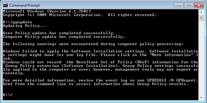

Hi, I'm having problems installing 21.0.0.213 via GPO
I've added the .msi as a new package as normal but it is not deploying.
If I run gpupdate on a client machine I get the following message;
If I disable the GPO for installing Flash (or remove 21.0.0.213) it works fine, gpresult returns no errors - although obviously Flash is not updated.

The output you post states to review the event log or run GPRESULT /H GPReport to get more information.  Did you do this?  What information did it contain?
I'd like to get some log files from you.  Please upload the following files, from the same installation attempt, to cloud.acrobat.com/send using the instructions at How do I share a file?
  • FlashInstall.log file saved at C:\Windows\System32\Macromed\Flash.  If this is a 64-bit OS there is another FlashInstall.log file saved at C:\Windows\SysWOW64\Macromed\Flash.  Both files are required from a 64-bit OS
  • Verbose MSI install log file
