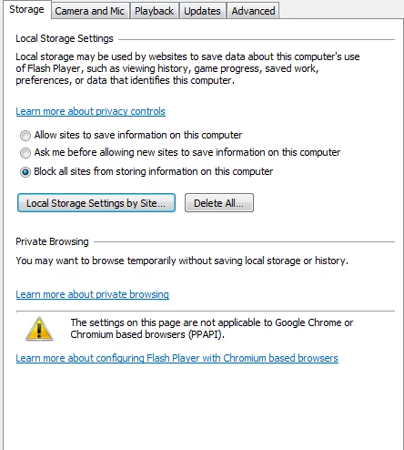

We're trying to set up mms.cfg settings to be the equivalent of the following settings in the Local Settings Manager.
For Local Storage Settings - "Block all sites from storing information on this computer"

So, what are the equivalent mms.cfg settings to mimic the Local Storage Settings "Block all sites from storing information on this computer"?  We've done extensive testing with the Local Storage "Block" setting and it works well for us.  We would like to migrate the equivalent to the mms.cfg file for administrative purposes.

Thank you for your response.  It seems to me that LocalStorageLimit affects the settings shown below.
versus
It would be reasonable to assume that if you set LocalStorageLimit=1 (no storage) then that would block all sites from storing information on the client.  I guess it all hinges on what "storing information" means - that's not very specific.
Please see the comments in mms.cfg LocalStorageLimit options
According to that thread, LocalStorageLimit=1 didn't prevent sites from storing on the local machine.
Is the proposed solution of ThirdPartyStorage setting of '0' and a LocalStorageLimit of '0' incorrect?  I don't see a "0" setting for LocalStorageLimit in the Admin Guide.
