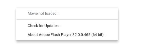

I have a Google Sites website where I post games with Flash. Since the end of life is in a couple weeks, I started putting HTML Games. There's this one particular game I want to add, called Milk Quest. When I get it set up, I enable flash and I am met with a white screen. When right clicking, there's 3 boxes: Movie not loaded, Check for updates, and About Flash Player. I use the same exact method to add other flash games, and they work. Any help with this issue is highly appreciated.

If the game "Run" works and every other flash game on your site can work right now I can only think of two things.
1) There is something wrong with the flash file itself. What you are trying to load is a broken swf or was never actually the game you were trying to get (sometimes people save a random swf instead of the game.)
Check if the swf works at all by downloading from here. https://www.adobe.com/support/flashplayer/debug_downloads.html
A version that says Projector Content Debugger I think is what you need. Load it and open your game with it. If you get the game to open I think that should mean the file is perfect.
2) Alternatively the issue is incompatability with the game and what is being used to play it. This I really cant help. If you tell me the site (something I would be happy to know anyway) I can check if it loads for me. If it doesnt we know its the fault of the site. Otherwise its your computer / browser.
If the file is perfect and the issue is the site you will need a different tool to play it. You can make the game a downloadable link and direct people to obtain a standalone SWF Player. (The thing I had you get.) Not sure how long that particular link will remain or if adobe has placed a kill switch into the program that will eventually brick it. There are however many independant SWF / Flash Players out there for all kinds of devices.

There's not enough information here to guess about it.  You'd need to install a Flash Debugger variant to see what error is getting thrown, and then go about resolving that error.  It's entirely dependent on how the game is built.

I can't download a Flash Debugger, Can I have instructions?
Jan 2, 2021 4:08 PM UTC
To avoid confusion yes I know you said you enabled flash. Fact is the thing bricked itself. To test if your flash is really enabled you can try loading this game that I know still works. https://www.albinoblacksheep.com/games/run
