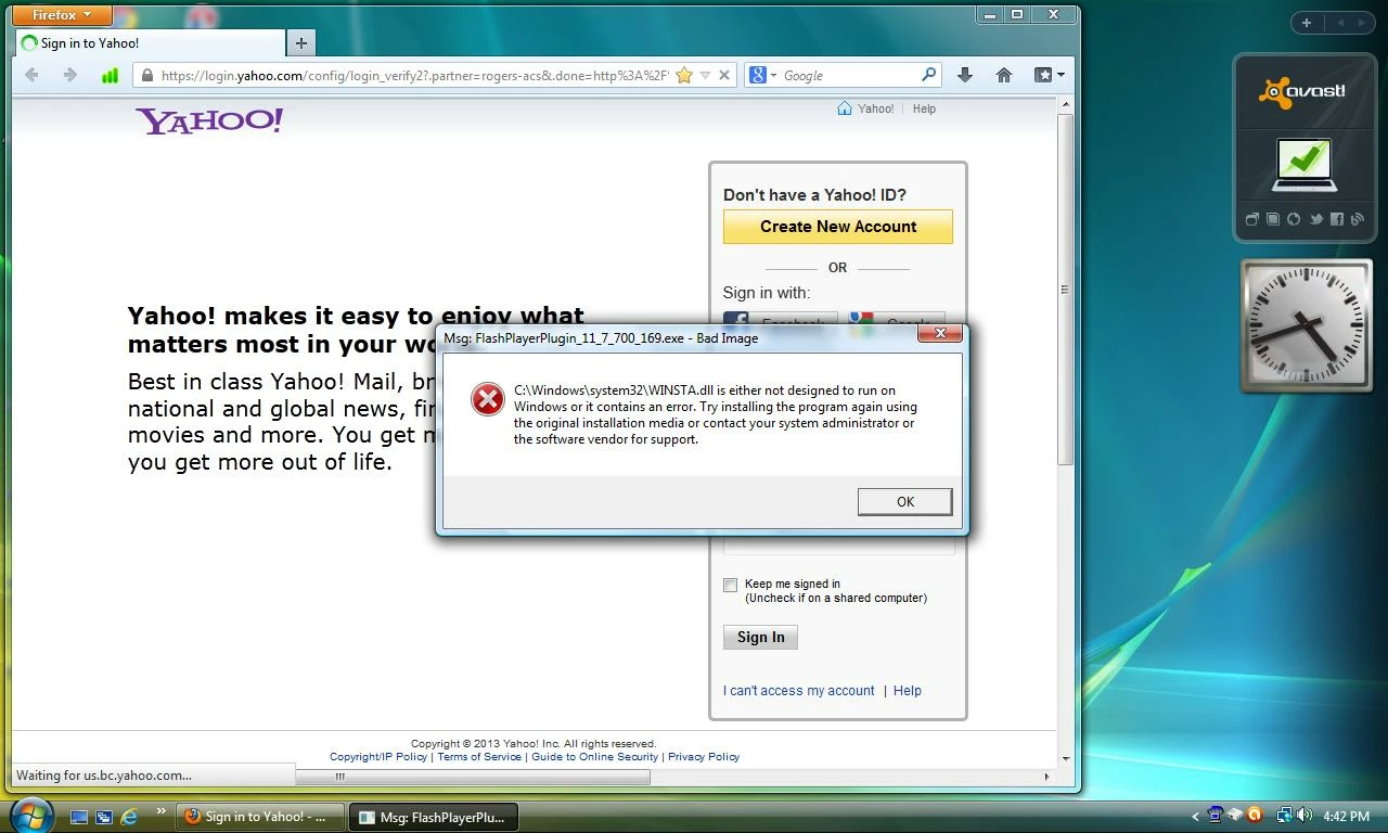

I am running on MS VISTA OS and whenever I now open Firefox I get a variant of this message: "Msg: FlashPlayerPlugin_11_7_700_169.exe - Bad Image"  The description goes on to say:
C:\Windows\System32\WINSTA.dll is either not designed to run on Windows or it contains an error.  Try Installing the program again using the original media or contact your system administratoror the software vendor for support"
I have uninstalled and reinstalled Flash.  I have uninstalled and reinstalled Firefox (maintaining my personalizations, i.e.bookmarks...).  The message continues to appear.
Having tried to Re & Re the obvious appplication I don't know how to further identify and remedy the root cause of this message.  Can anyone give me directions on what to do next?
pwillener
May 1, 2013
You have a system file that is corrupted; try repairing it with the System File Checker.  From an Administrator account run
sfc /scannow
You may need your Windows install disk for this.

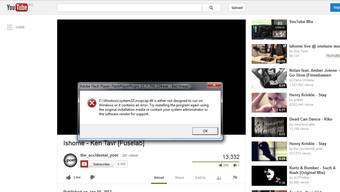

Hello
is not working with sfc/scannow, any suggestion please?!! i have same error, winows 7!!
please help me!!!
Thank you
pwillener
July 6, 2013
This is not the same error; yours shows a corrupted Nvidia driver file.  Reinstall the latest Nvidia driver for your graphics card.
