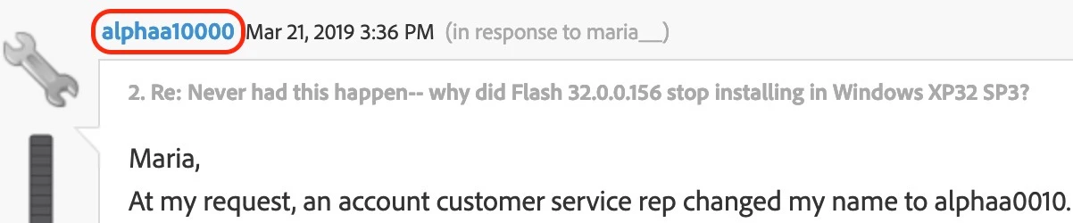

Maria,
At my request, an account customer service rep changed my name to alphaa0010. Could that be done for this thread, as well? I originally supplied my name as part of the account creation process, never imagining it would be taken up as the name used for any thread I posted. In fact, I do not recall ever having been shown where and how the account name would be used.

Mar 22, 2019 3:23 PM UTC
HI alphaa10000
When logged out of the forums, I do see your user-name as:
However, when logged in I do see your full name.  Forums users can configure how their name displays in their profile.  See the Forum FAQs for instructions on configuring this.
