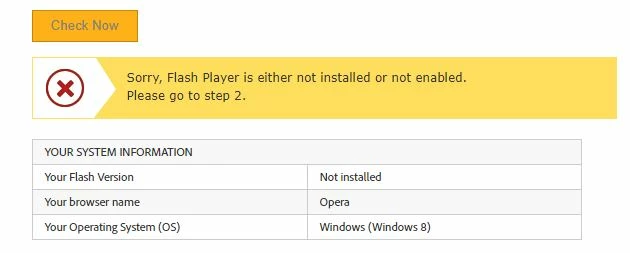

I have gone to the Adobe Flash Player Install for all versions and tried installing that version, but I still get the same message and if I go to  Flash Player Help to check to see if it is installed it says that it is not installed on my computer.  (it also states that I am running windows 8 but my system is windows 10 now).

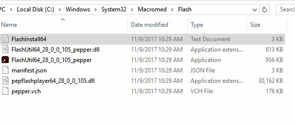

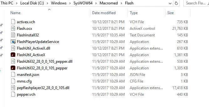

I have tried uninstalling and then installing the player multiple times.  I have used the uninstaller that I found at Uninstall Flash Player for Windows and then followed the steps there - but I was unable to delete all the files found in C:\Windows\system32\Macromed\Flash so I renamed the folder to flash.old
I am not sure exactly what is meant for the next step  (am I supposed to delete those files / folders as well?)
Follow steps a, b, and c for the following:
C:\Windows\SysWOW64\Macromed\Flash
%appdata%\Adobe\Flash Player
%appdata%\Macromedia\Flash Player

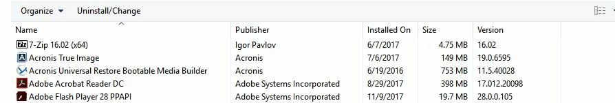

I have been trying for the past 3 hours to get the darn flash player to install and work with no luck at all.  It is showing as being installed in Control Panel     Programs and Features.
I have tried the 3 different downloads

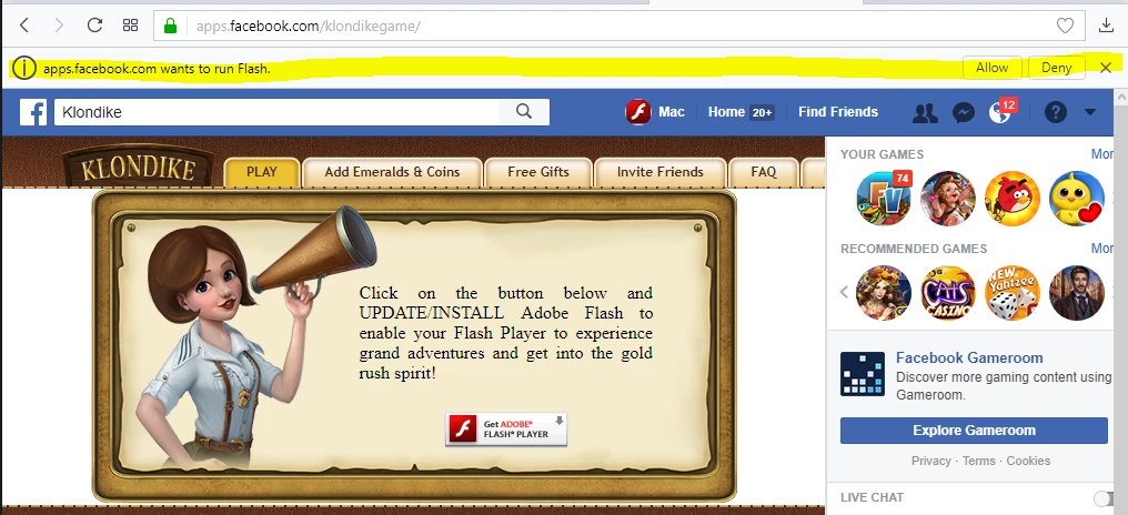

I then updated to Opera 49.0.2725.34(PGO).  I navigated to helpx.adobe.com/flash-player.html and at first, the browser did not detect the Flash plugin.  I manually added the domain to the list of exceptions for Flash to play:

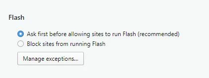

  1. Launch Opera
  2. Navigate to settings
  3. In the menu on the left, select Websites
  4. Locate the Flash section and click Manage Exception button link
    • Alternatively, skip steps 2-4 and go directly to opera://settings/contentExceptions#plugins
  5. In the Hostname pattern field enter helpx.adobe.com and in the corresponding drop-down menu, select Allow
  6. click Done to close the Manage Exceptions window
  7. Refresh/reload Opera and navigate to helpx.adobe.com/flash-player.html
  8. Click the Check Now button
  9. Opera will now allow Flash content and display the version installed:

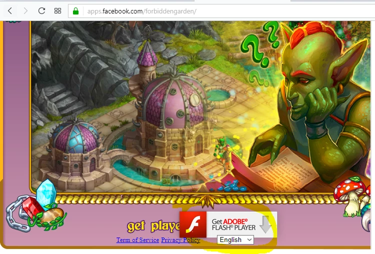

You will  need to Allow flash on both sites you provided by clicking the 'Get Adobe Flash Player' button, which will display the option to allow/deny Flash.

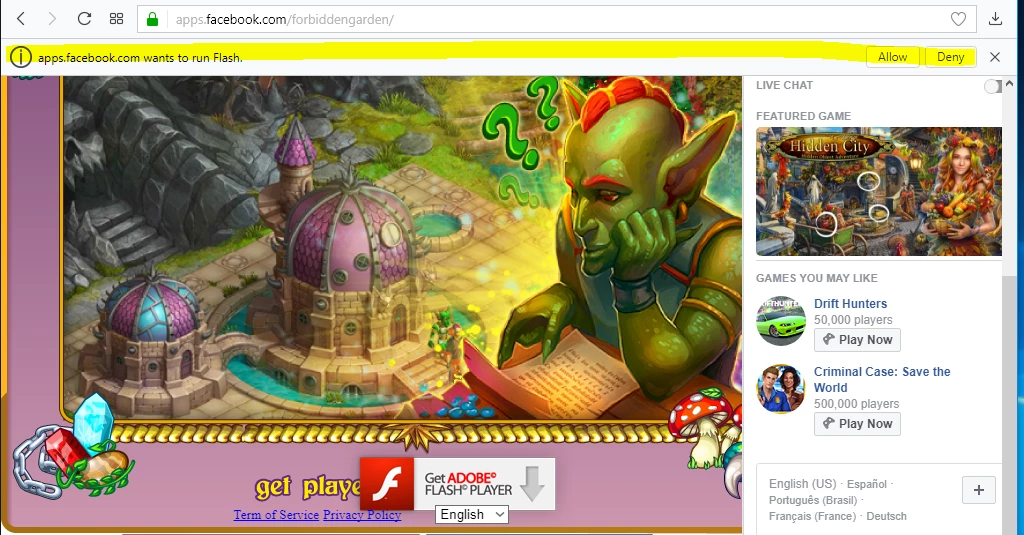

Forbidden Garden game:
Click the Get Adobe Flash Player button
The info bar displays, asking to allow/deny flash.  Click Allow

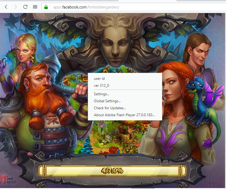

Opera enables Flash and the game plays with Flash content:

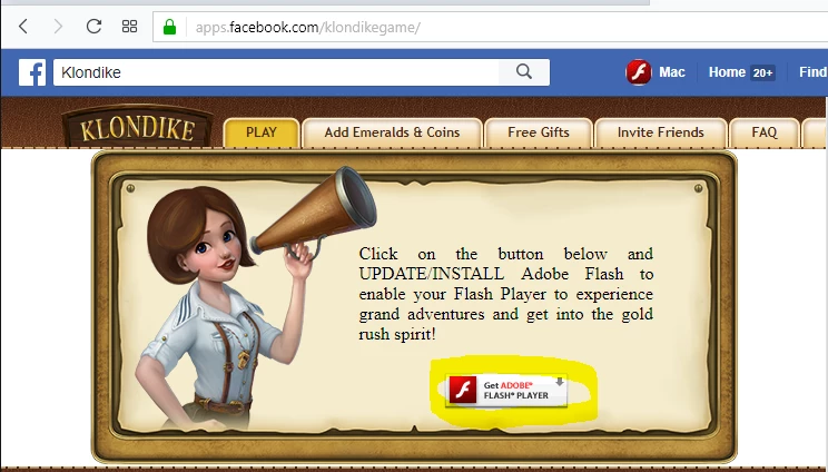

Klondike game:

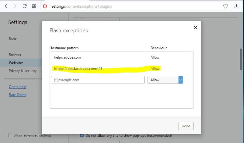

If you navigate back to opera://settings/contentExceptions#plugins you'll see that https://apps.facebook.com:443 has been added to the list of Flash Exceptions.
As long as this is listed here, you shouldn't have to 'Allow' Flash again on https://apps.facebook.com:443.
