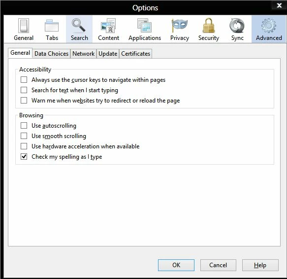

I've been going over this problem for months now and I think I may have at least solved my problem and I'm hoping it works for others. This is not a solution to all and some of you should be able to solve problems with an add-on update or reset. All through out the day my browser would just crash and become unresponsive. Usually due to Flash issues and unresponsive script. I have tried uninstalling Firefox and also resetting,  and even kept Adobe flash up to date all to no avail. Finally I ended up disabling my Hardware Accelerator and Smooth Scroll and so far I haven't crashed today. I am keeping my fingers crossed but so far it has been a good sign. I usually crash at least 20 times a day. I am hoping that it works for others as well. Here is a picture of the settings for people having a hard time finding it.

Verified that disabling the smooth scrolling worked for me. Its been three days without a crash. In my case the hardware accelerator didn't do anything. I still crashed. I don't understand why smooth scrolling would cause my browser to become unresponsive like that.

I just disabled smooth scrolling. Even disabling hardware acceleration didn't help prevent this.
