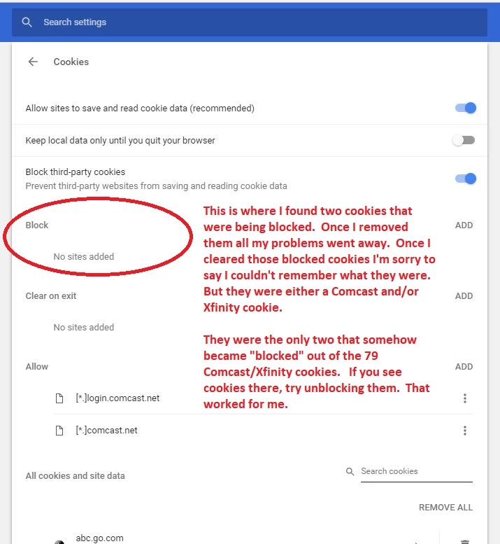

I finally found the problem !!    This is what worked for me using Chrome.  There are two options in Chrome, either one can cause the TV problem.   The above image is of the cookies area in chrome.  The other area that is not imaged here is from the same page but under it's Flash player setting.

There I found that some how there were two items that were listed as being blocked.  I never blocked them and I'm sure those items were not there before problem happened.  The two items (being blocked) consisted of an xfinity URL and a Comcast URL.
I removed them from the "blocked" list.  And just for good measure ADDED a couple Comcast *.net" URL's to the "Allow" list.  Check your items listed and if you see something referencing Xfinity or Comcast.  Jot it down (in case you have to revert to the original setting) and delete them ... close and open Chrome and see if you can now get your TV viewing okay.
If that doesn't work there is another setting to check, under "Content settings".  The first item there is "Cookies".  Open that up and make sure under the "Block" settings there are no comcast or xfinity entries there. If so delete them and close the browser and log back on.
Hope this helps ...  For me, with Chrome, all is well again.
NOTE!  I only use Chrome but I also installed and tested Firefox and Edge.   Comcast TV still won't work with those browser for me.   I'm only guessing but there may some similar setting in those other browsers that I just haven't found yet.   Someone with a better understanding of those browsers might find similar settings.
Generally you want to make sure your browser doesn't have any comcast or xfinity entries in the "blocked cookies" area, if one exists.   Also in the settings area of Flash player, make sure there isn't some option to "block or stop Flash".
