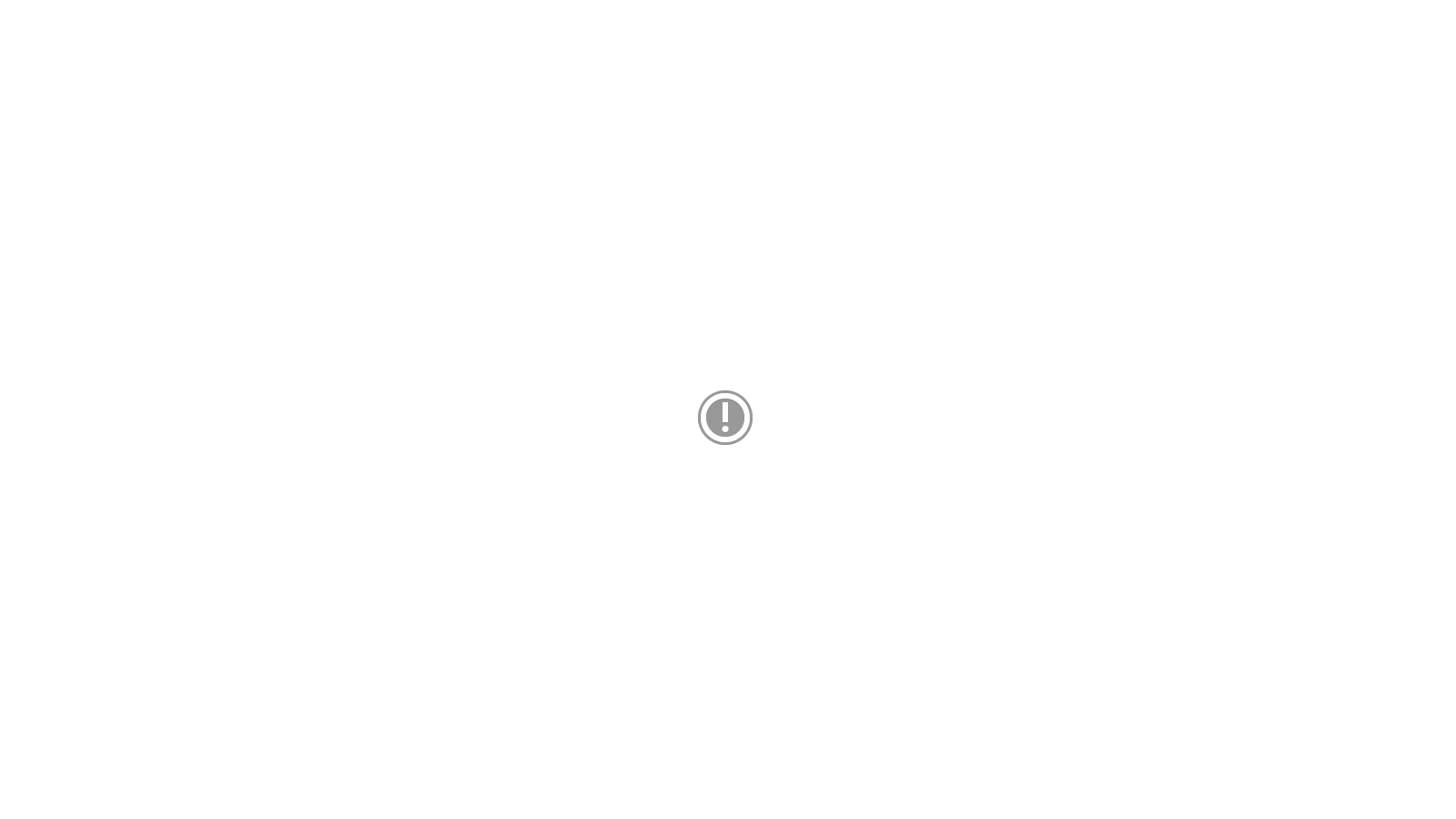

Tengo un problema con un archivo "SWF", al ejecutarlo marcha bien, pero al pasar un determinado tiempo la pantalla se pone blanca con un signo de exclamacion gris, tengo que cerrar el archivo "SWF" y volverlo a ejecutar. ¿alguien sabe el porque se da ese problema?
******Los Drivers de video estan bien instalados.***
Les Adjunto una imagen de como se ve la pantalla, no da ningun mensaje de error, solo se pone blanca con el signo de exclamacion.

The icon you're seeing is the Out Of Memory icon.  The SWF you are running is eventually running out of memory.  Typically this happens because the content is allocating objects, but not freeing them such that they can be garbage collected.  Eventually, no new memory can be allocated and we stop executing.
If this is your SWF, we offer a profiling tool called Adobe Scout that should help you identify the problem.  Also, if you're not running the latest version of Flash Player, I would recommend updating to see if the issue is resolved.  We did have a recent bug where under specific conditions, some objects were not being correctly garbage collected; however, I believe that this is solved.
