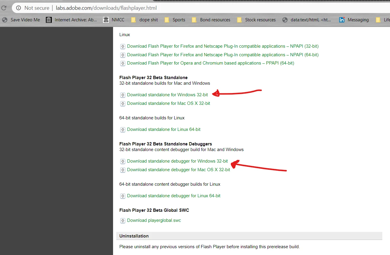

I have a server located 'https://aca-client.axeda.com:9443/web/'. I have verified that if I go to "https://aca-client.axeda.com:9443/web/Shell.swf" on browser, it download the swf meaning, its there on the server. Now I don't want to run that swf file on browser. I want to run it over an stand alone flash player. So I download the flash player from "https://labs.adobe.com/downloads/flashplayer.html" website. hover to the link, A) For non-debug version, go to 'Flash Player 32 Beta Standalone' section and click on link 'Download standalone for Windows 32-bit' A) For debug version, go to 'Flash Player 32 Beta Standalone Debuggers' section and click on link 'Download standalone debugger for Windows 32-bit' This will download the two standalone flash players (debug and non-debug mode)

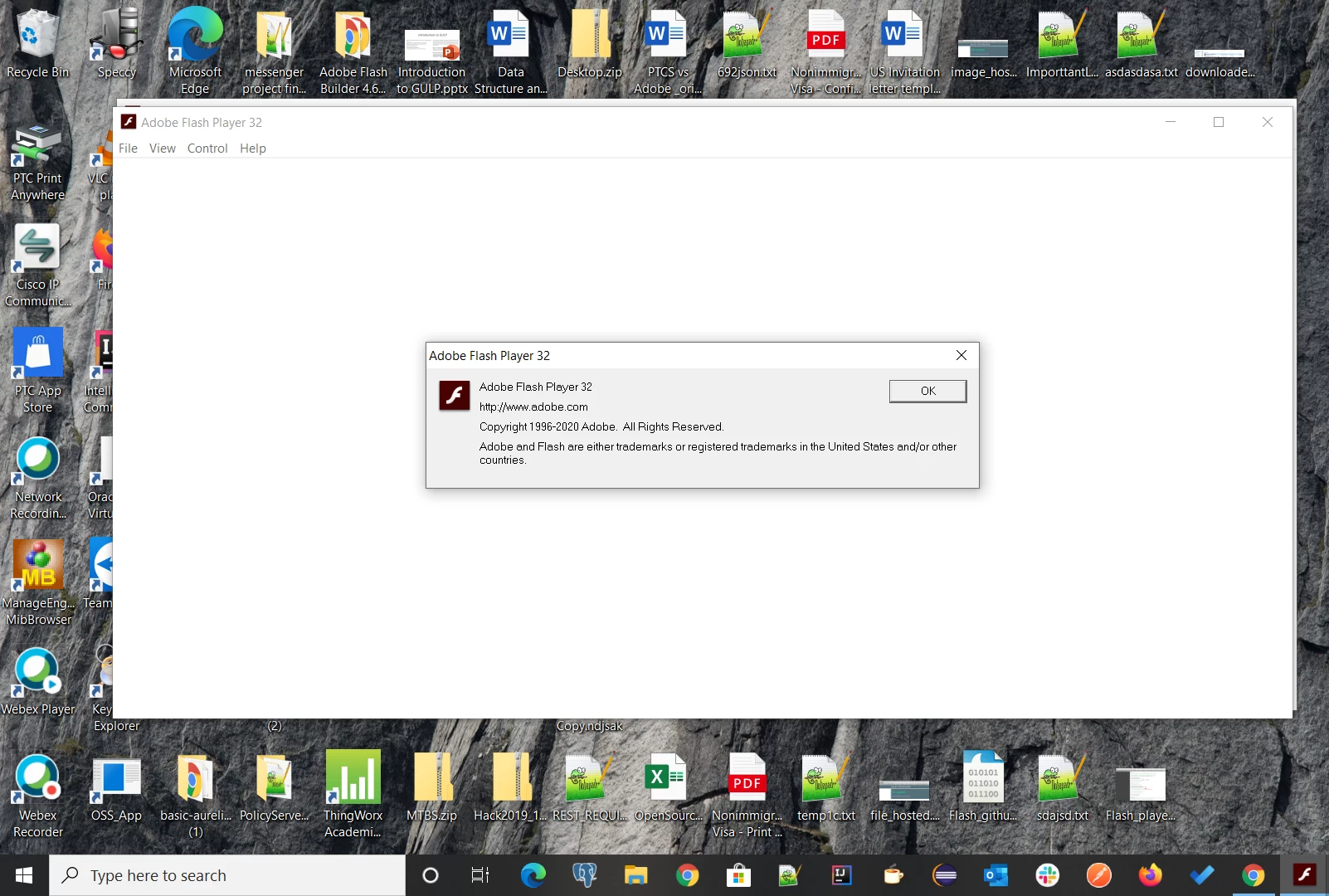

1) Please refer to 'flash_version.png' that shows the version of flash_player.

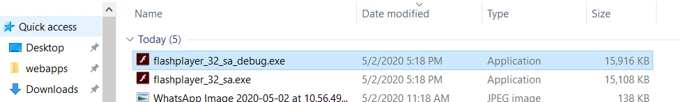

2) Please refer to 'downloaded_players.png' that shows the two exe files getting downloaded when you click on links shown in 'Flash_player_download.png'

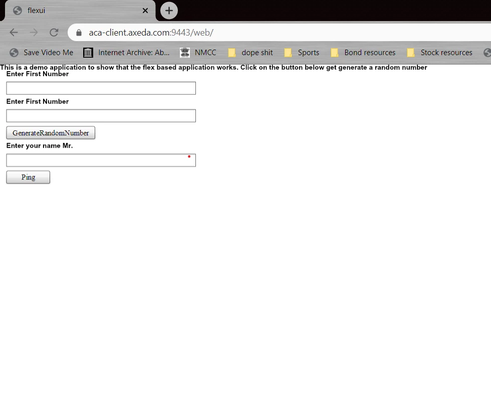

3) Please refer to 'application_opens_on_9443_in_browser.png' which shows that the flash application was accessible in browser at "https://aca-client.axeda.com:9443/web/". Ofc I have run flash plugin in browser at that time.

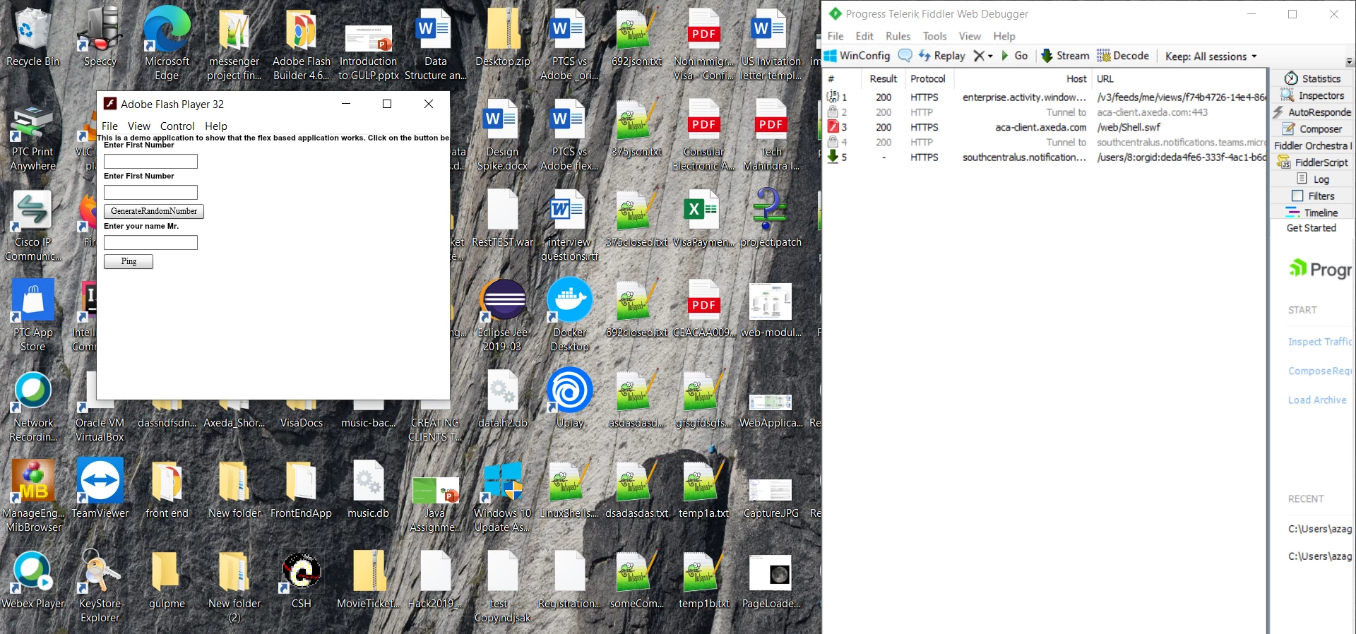

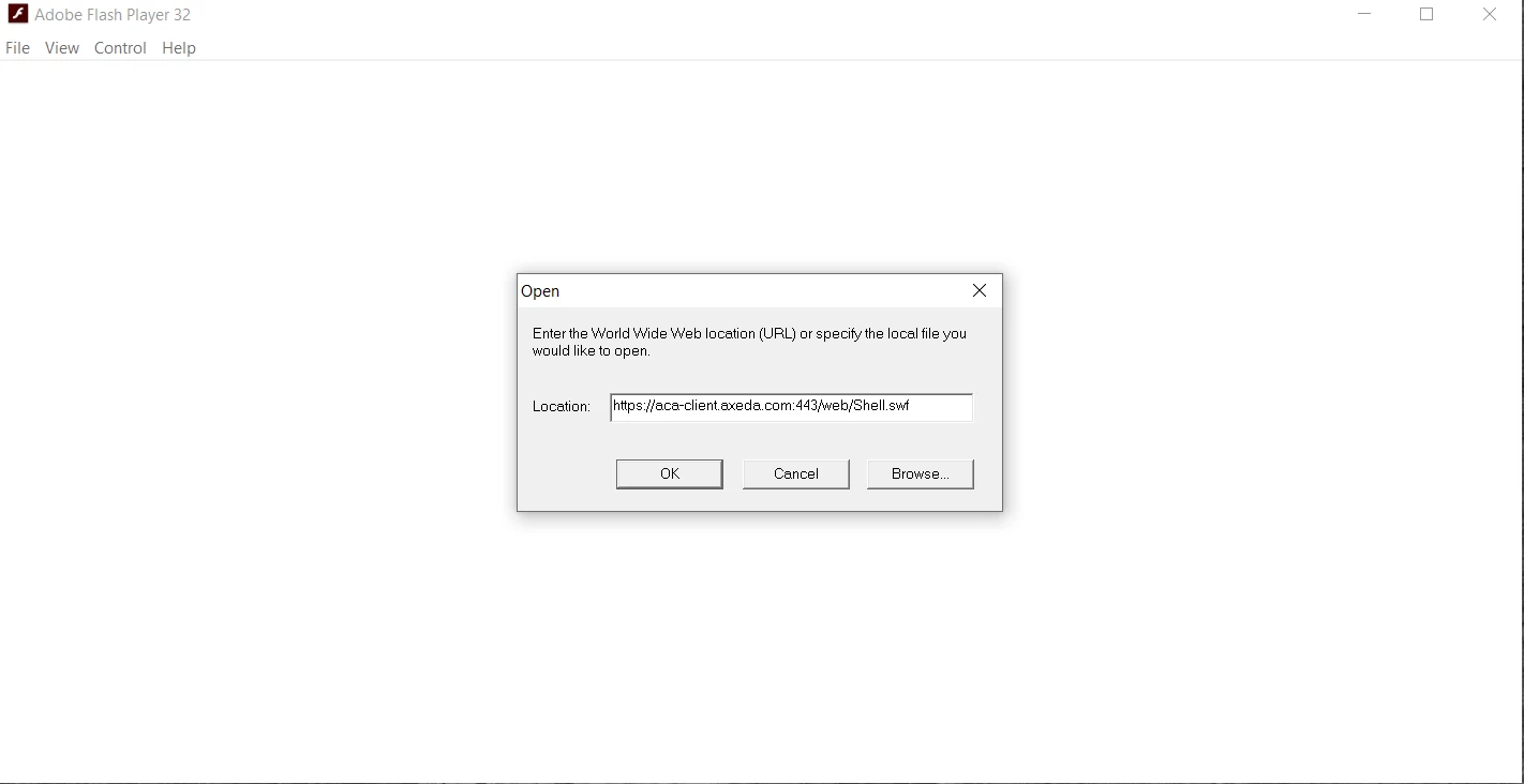

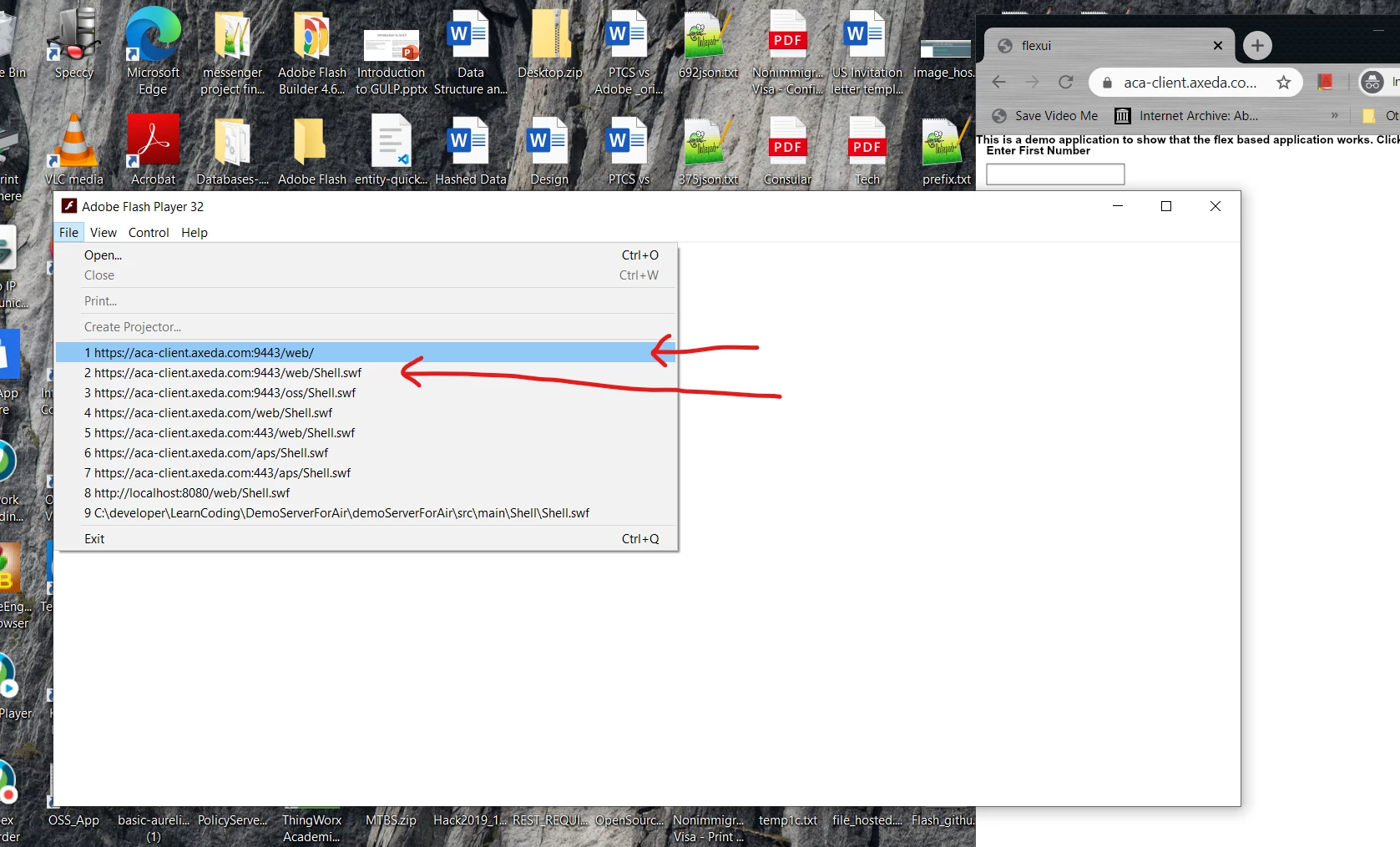

4) Please refer to ''links_I_open_on_flash_standalone_player.png" when open a remote swf file in flash player ( not Browser !!!!).
5) Please refer to "swf_does_not_load.png" to see that nothing happened.swf did not load.

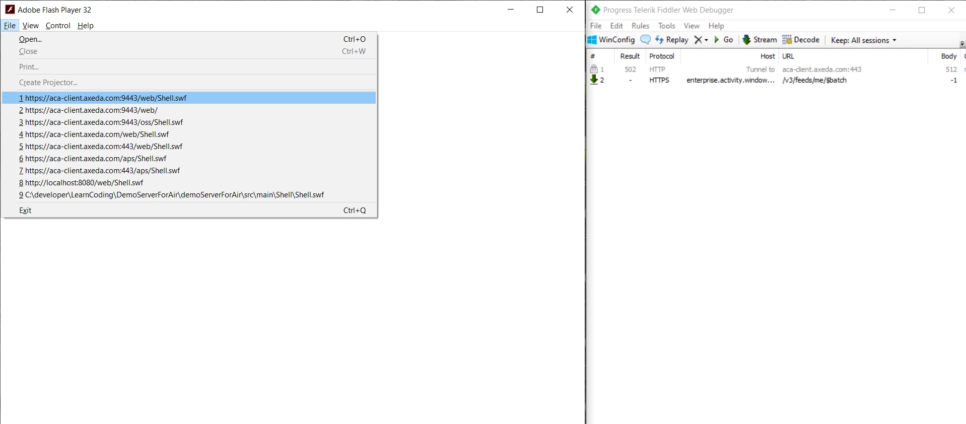

6) Please refer to "Call_traced_on_fiddler_when_accessing_swf_on9443.png" to see the network calls traced on fiddler when i go hit "https://aca-client.axeda.com:9443/web/Shell.swf" on flash player.

Now, instead of server hosting the swf file on 9443, I configure the server to listen on 443, which is standard SSL-port.

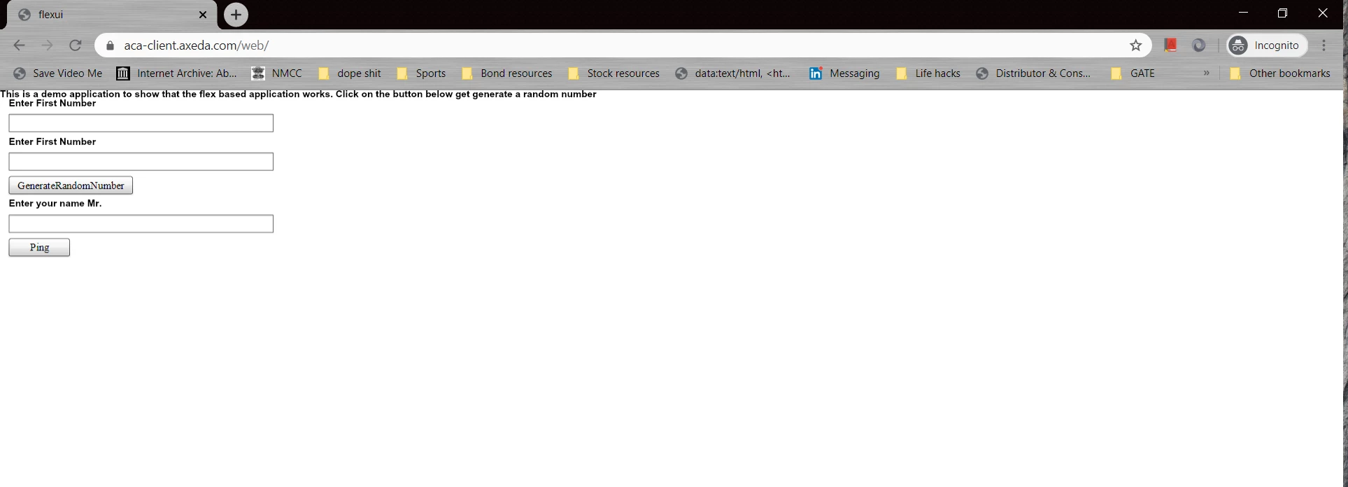

1) pls refer to "1.png" where i load "https://aca-client.axeda.com/web/" and application works fine
2) Then I open flashplayer_32_sa_debug.exe and the opent the link "https://aca-client.axeda.com/web/Shell.swf". See '2.png'
3) refer 3.png to see that the swf file got loaded. SO MY QUESTION IS WHY ARE REMOTE SWF FILES NOT LOADED FROM SERVER OVER SSL ON NON_STANDARD PORTS ? I already have valid cert on server.
