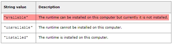

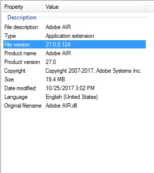

I have sent you a release build of  swf file in a message. When we try to run the swf file via web application it checks the air run time has installed or not and gives the status as "Available".
We have installed adobe air and current version is 27.0.0.124.
Since the application is a web distribution is that enough to go only with air installation?

I have created bug FP-4198687 for this issue. I have also updated the test case in the bug to make the button larger, so you can easily see the error message and status. If you open the test case from the bug and run "lauchAppWeb.html" in Internet Explorer you should see a message that says "installed", letting us know the AIR run-time is installed on the machine.
If you run the same test case on Chrome or Firefox you will get a message saying the run-time is "not found", but can be installed. You will then see a status message of "available". It appears that with the latest releases you can no longer detect the air run-time although the run-time is installed.
Hope this clarifies what Thanuj was saying.
