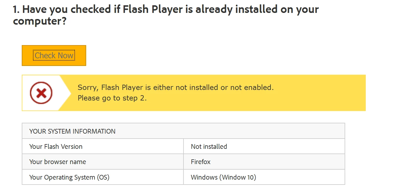

I am having massive issues with installing Adobe Flash 24.0 my Windows 2016 Server and I am getting conflicting information. I also can't see Flash in the Managed App in the Toolbar and Extensions. Even with following the steps documented on the website I am unable to get flash to install and a number of programs require it.

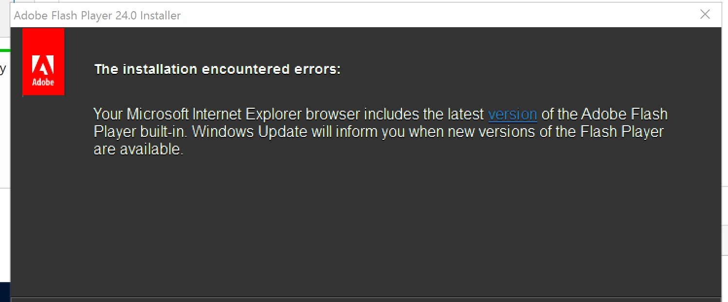

When running the exe install of Flash is states that it has been installed yet on the website it says it has not additional as mentioned it doesn't appear in the Managed Apps.
Any help would be appricated as since this as switched from the exe to the intergrated way its been a pain!

As of Windows 8 Microsoft embeds Flash Player in IE, including Windows Server 2016, as such, the standalone installer (exe or msi) do not run on the platforms that embed Flash Player.   Flash Player is present on the system, but it is not enabled.
I found the following Microsoft technet blogs that may provide assistance.
Further queries on this issue, including assistance to enable/activate Flash Player, should be directed to Microsoft, not Adobe.  Adobe provides Microsoft with the files and they embed them and control how it's enabled/disabled on a system.

Thank you very much for the help - the answer was in enabling remote desktop services. Though this seems like something that you should raise with Microsoft to improve. Also improving the step by step on your own website as this isn't mentioned at all.
