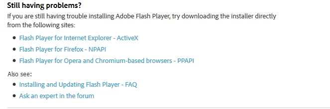

You might need to use the current offline installers.
Make sure that Firefox is NOT running, and make sure anything Flash or plugin-container is not running either in task manager; those are some additional things that could bork up the install.
Scroll down to the bottom of the page until you see the 'still having problems' like the blown screenshot !
Download and install, hopefully it will be that simple for you
There is additional information regarding this here
