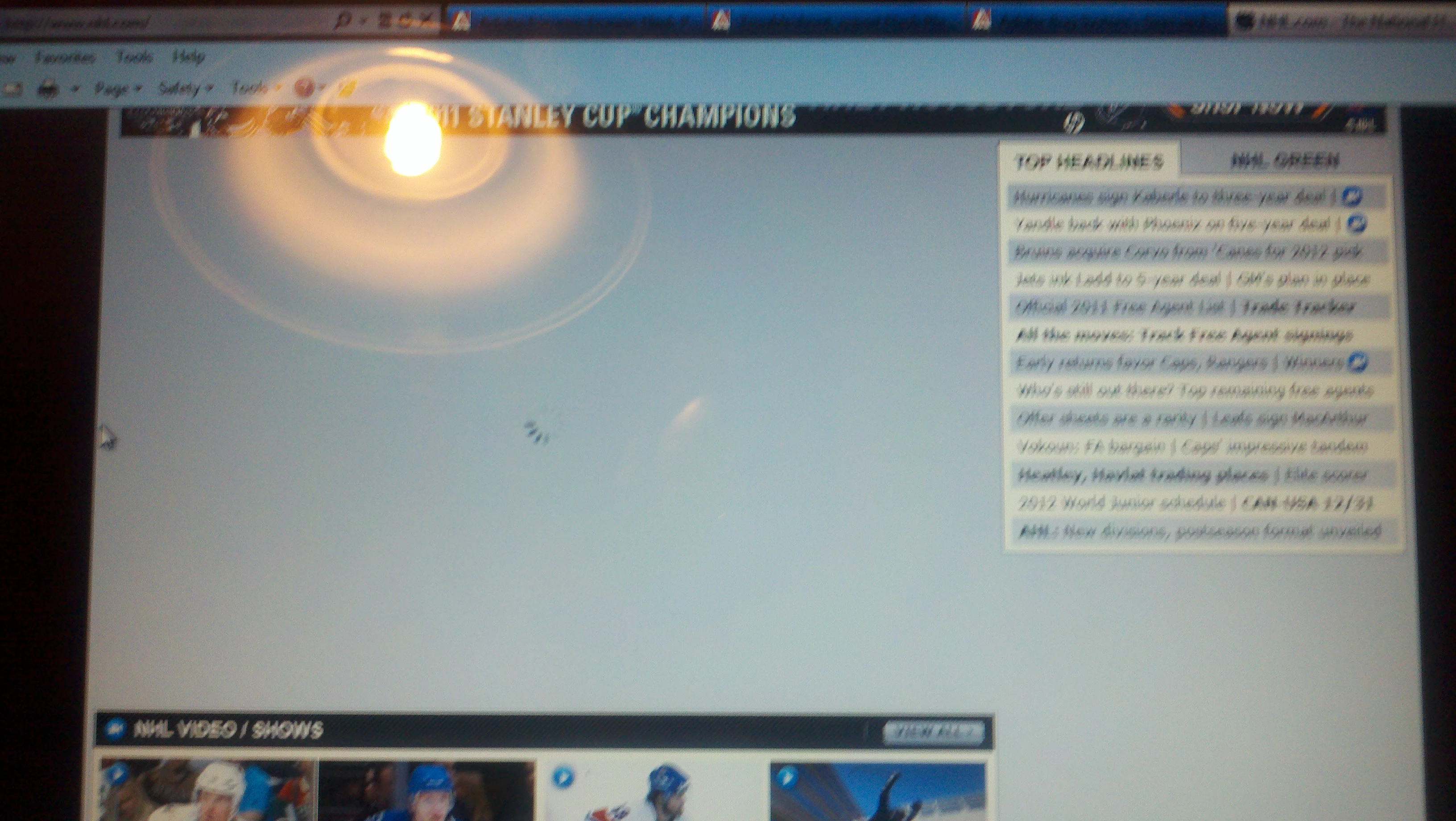

Ever since the most recent updates, Flash does not load properly on my computer

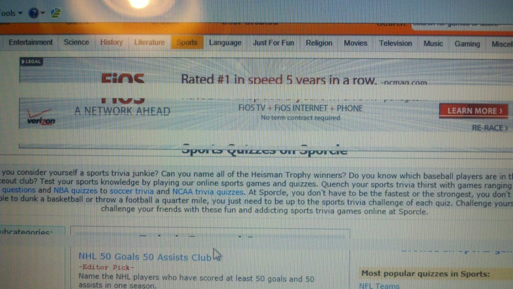

See above for NHL.com.  Should be flash-enhanced programming in the middle, but it never loads.  On other sites, the flash programming is missing entirely, misplaced or has one or more lines going through it.
I know it has to be a Flash issue because when I disable Flash the problems go away.
Thanks in advance.
Mike
