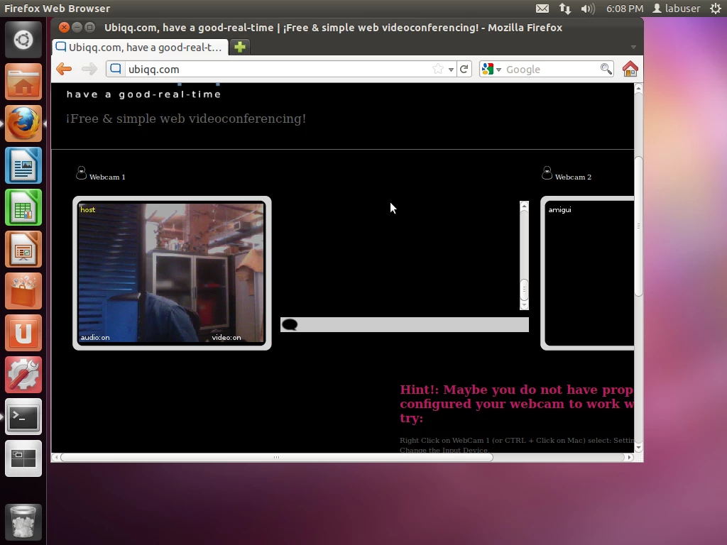

I have on my laptop Ubuntu 11.10 64bit with Firefox, I installed flash player 11 (64bit) from the Ubuntu Software Center (version flashplugin-installer 11.0.1.152ubuntu1).
When I browse websites that use webcam like ubiqq.com, chatroulette, etc... the flash popup asking me for webcam access permission shows up as usual, but I can't push any allow/disallow button, the popup is blocked and not responding. I did not have this issue with Ubuntu 11.04 and using the same version of flash player downloaded from adobe site and put it manually in the right folder.

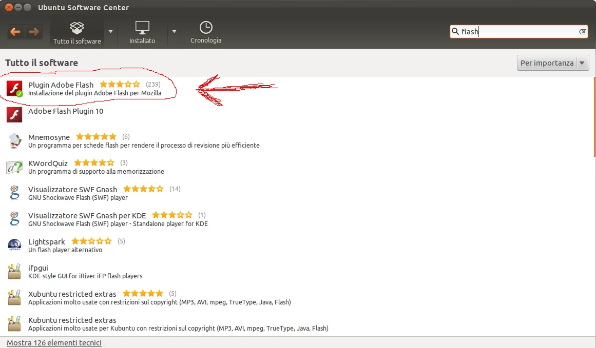

    I installed the first one you see here, it should be 64 bit:
