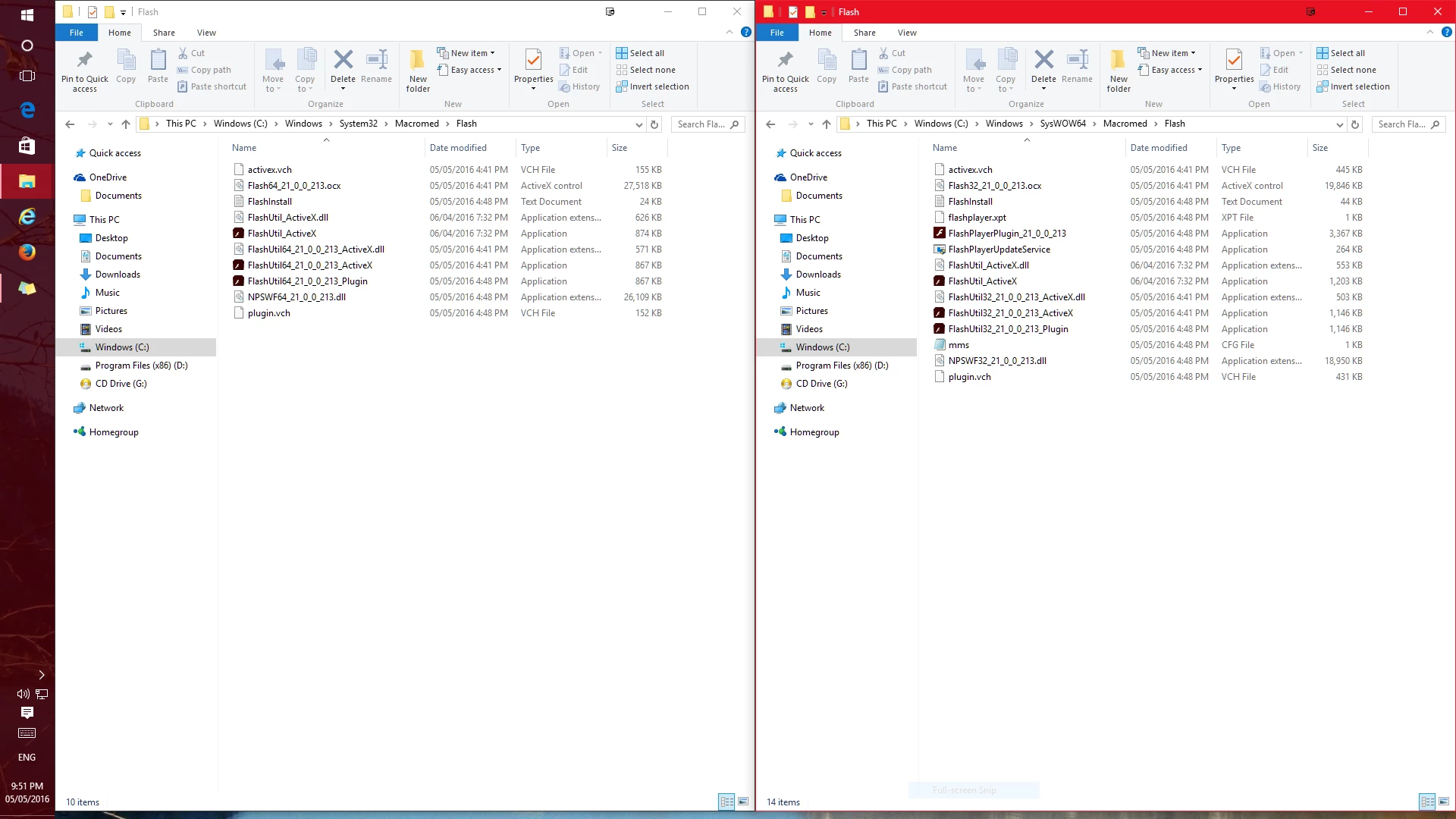

The files needed for flash content seem to be in the correct locations, I have tried removing Internet Explorer then reinstalling it, Grr and ive tried what the adobe help page says... to turn ActiveX off and on, also to make sure the plugin is turned on, which it is

Just to add, This could be a registry problem, I have found some entries that are not the same, however I think the entrys have changed, because i installed flash player manually, under windows 8 compatibility mode under windows 10, I did this, because flash player stopped working, as I explained above,
Bodge Solution
download :
https://fpdownload.macromedia.com/pub/labs/flashruntimes/flashplayer/flashplayer_22_ax_debug.exe
or go to :
Download Adobe Flash Player 22 Beta for Desktops - Adobe Labs
choose
Download Flash Player for Internet Explorer - ActiveX
install the setup, under windows 8 compatibility mode under windows 10
then change the following
C:\Windows\SysWOW64\Macromed\Flash\Flash32_21_0_0_213.ocx
C:\Windows\system32\Macromed\Flash\Flash32_21_0_0_213.ocx
need to be changed to :
C:\Windows\system32\Macromed\Flash\Flash.ocx
C:\Windows\SysWOW64\Macromed\Flash\Flash.ocx
you will also need to make the changes in the registry, by opening run, and enterying regedit then press enter,
HKEY_LOCAL_MACHINE/SOFTWARE/Macromedia/FlahPlayerActiveX
click on the PlayerPath and change it to :
HKEY_LOCAL_MACHINE/SOFTWARE/WOW6432Node//Macromedia/FlahPlayerActiveX
warnning, this is a l@zy fix, a bypass, to force it to work again! follow at your own r!sk,

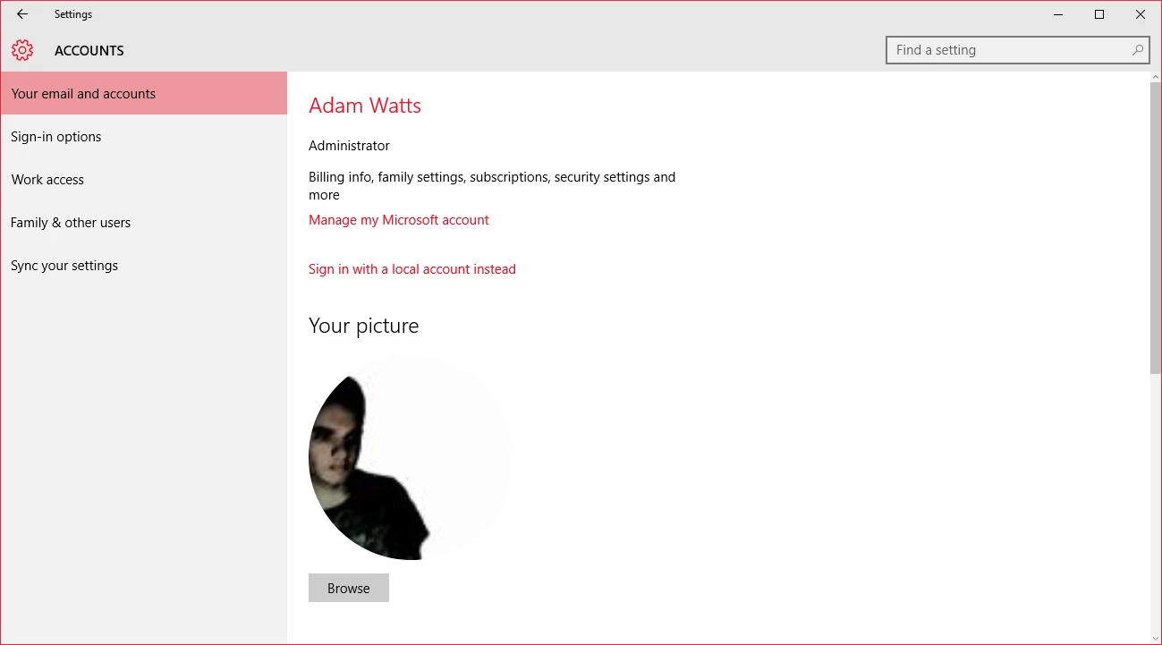

Thank you for the detailed report.  Is this on a standard user or administrator user account?
We've received reports that administrator user accounts work, but not standard users, however, we've not been able to reproduce and it's been difficult getting additional information from users.  We have also escalated to Microsoft and they've not been able to reproduce it either.  Thank you for mentioning KB3154132.  This is information we've not had before.
Maria
May 5, 2016 9:39 PM UTC
This is on an account that is in the administrator group, so yes it is an administrator account, the kind of setup you would find on any new windows 10 computer, the 1st account being made, it was not an upgrade but a fresh install of windows 10 pro (clean)
