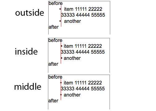

Thank you for your reply. I will try to explain in more details what I was talking about.
As part of setting up bullets in InDesign, I use "left indent" to set where the left side of the text is. In TLF, I am using listAutoPadding to do the same. If this is not correct, please let me know what attribute I should use. This left indent/listAutoPadding/left side of the paragraphs line up in a vertical "line," and that's what I meant by listAutoPadding line. It's not an actual line, it's just where the left side of the paragraphs line up against. In the image enclosed, I'm drawing this line in red, to illustrate and use as reference.
For list style position as outside example I gave, let me try to "draw" it using text, and use arrows to show the directions the bullet can move.
<- * ->  Text start...
         text continued...
In this outside example, I can move the bullet left and right by changing the value of paragraphEndIndent. However, I noticed that the smallest value I can set is 0. Negative values are treated the same as 0. This means the right most I can place the bullet is just to the left of left indent/listAutoPadding. In the enclosed image, please refer to "outside" item.
For list style position as inside example, I'd have something like:
          <- * -> Text start....
          text continued...
In this inside example, I use contentBefore in combination of setting tabStops to place the bullet. However, the left most position I can place the bullet in this case is using empty content before, and that puts the bullet against the left indent/listAutoPadding on the right. In the enclosed image, please see "inside" item.
This leaves a gap between the two ranges, and that gap is with the bullet right on the left indent/autoListPadding. In the enclosed image, please see "middle" item. If I want to place the bullet on this left indent/listAutoPadding line, I can't seem to use either outside or inside settings. Please advise on how I can achieve this effect. Thank you.

The best docs we have on lists is here: http://blogs.adobe.com/tlf/2010/07/tlf-20-lists-markup.html.
"listAutoPadding" is the padding applied to the list if the padding value of the list element is set to "auto". So if you set the padding to 0, no padding will be applied, leaving the list paragraphs at the same indent level as the outer paragraphs. You can move it in from there to anywhere you want, using postive numbers, or out using negative numbers. But you'd have to calculate the exact setting required for having the bullet in the midpoint, depending on font and font size; that's not a calculation TLF will do for you.
Hope this helps,
- robin
