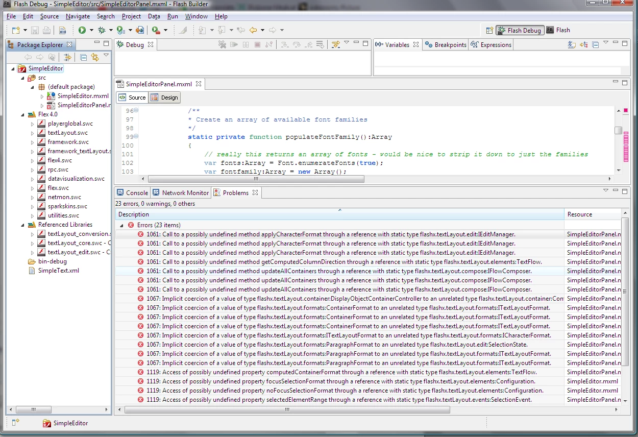

I am having problems getting started with TLF.
I am running Flash Builder under Windows Vista, I have included all the libs needed but i cannot get the app started.
You can see the errors I am getting into the attached image.
Is something wrong with the libs I try to use... or...??? i have no clue how to get started
Thanks in advance!
Adrian

Ok.. I found out what it was:
1. Started Flex Builder 3
2. Opened the project properties and selected the flex 3.2 SDK
3. Opened the project properties and selected the flash version to 10.0.0
After clean-build all errors disapeared
Thanks anyway!

If you did want to continue using the example with Flex 4 there were a couple of problems.
1) The tlf swcs were double included.  You added them and they are already bundled into Flex 4.  The 3 swcs are merged into textLayout.swc.  I suspect they were different and incompatible versions.
2) The SimpleEditor example source was out of date for the Flex 4 textLayout swcs.  Unfortunately as part of the move to open source the most recent examples are no longer posted.  I'm trying to get that fixed.
Richard
