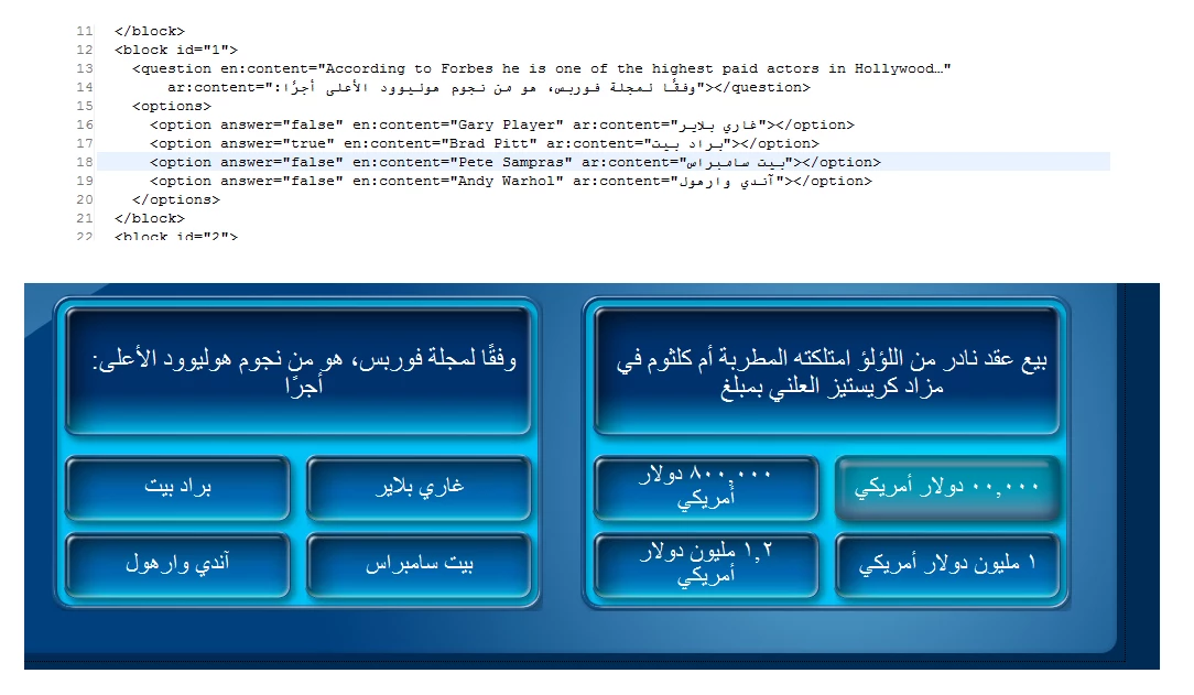

I am pulling this data from xml, but all full stops and colons goes to the end of first line, see the snapshot.
By the way I tried using direction attribute Direction.RTL for paragraph, span and textFlow but output gets worst, and in fact its much better without defining direction except this dot and colon problem.

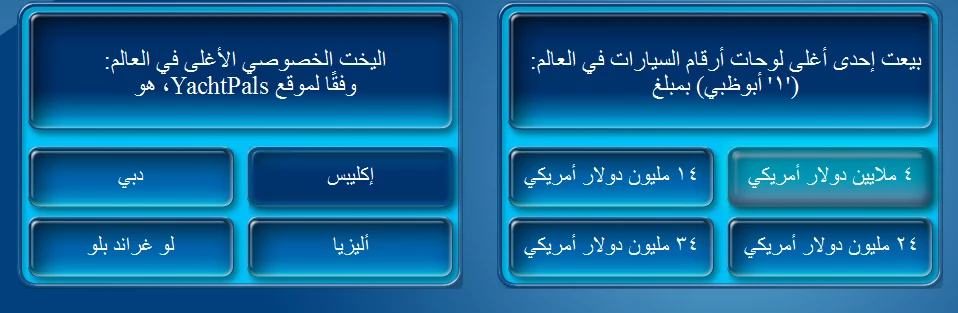

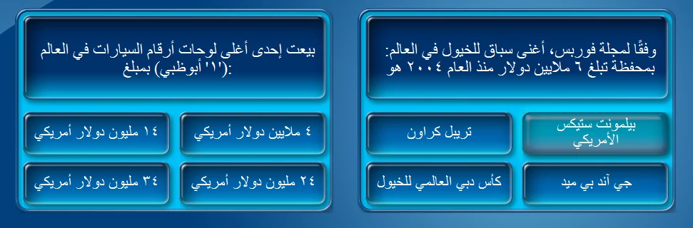

Feb 15, 2010 9:12 AM UTC
Thanks for the help.
I copied your arabic line into my xml and it goes to the beginning of 2nd line, kindly see error2.jpg.
Next step, in my xml I managed to type : at the end, it appears perfectly in my xml but again ends at the end of first line. I want this to appear at the end of the sentence. Kindly see error3.jpg
Please advise or if you can also post your xml file, I will also test with that.
Yes the content is Bidirectional and in fact this is what we use mostly and I read that Bidirectional text issue is solved in Text Layout Framework, do I miss something in my action script code?
